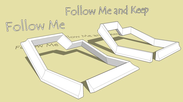

bbankston Posted December 30, 2010 Author Posted December 30, 2010 The 90 deg. turn from the 10 deg. angle wants to be exactly perpendicular. Meaning, once it's made the 90 deg. turn it's angled at 10 deg. (see thread 11 last picture). Quote
bbankston Posted December 30, 2010 Author Posted December 30, 2010 I know it's a compound miter and I could do the clean up myself I'm just unsure as to what plane I'm turning the "saw" for the 5 deg. angle after the 45 deg. angle. I feel like I'm being way too confusing. Quote

troggarf Posted December 31, 2010 Posted December 31, 2010 Are you using the "Pushpull" tool or the "Follow Me" tool? Quote
ReMark Posted December 31, 2010 Posted December 31, 2010 Would PressPull work in a situation where you not only change direction but elevation (10 deg angles) at the same time? Quote
troggarf Posted December 31, 2010 Posted December 31, 2010 No the press/pull tool wouldn't work. I was just wondering what method was being used. I think that I am now confused even after reading through the thread a couple of times. Did he get it to work? Quote
ReMark Posted December 31, 2010 Posted December 31, 2010 I'm pretty sure he used the EXTRUDE command. Maybe he should have tried SWEEP too although I've seen some unusual results with that command too. I drew the path using the original lengths and angles (both horizontal and vertical) and attempted to extrude the base shoe profile and got the same results. I think he then changed one of the vertical angles but I'm not sure which one. He mentions something about a 5 deg angle. I used 10 deg angles. This problem could most likely be solved with Inventor easier than trying to do it with AutoCAD in my opinion. Quote
bbankston Posted January 3, 2011 Author Posted January 3, 2011 troggarf & ReMark, I'm using Google SketchUp. I have to seeing as how I only have AutoCAD LT at work. And I am using the "Follow Me" tool. And I also never got it to work. Quote

troggarf Posted January 3, 2011 Posted January 3, 2011 The problem is at the second angled line. There needs to be "landings" both before and after the angled line. I don't know why, but I cannot load images on this website (cadtutor) to help so I will try to describe it. The landing needs to be a little wider than the width of the object that you are extruding using the Follow Me tool. If this isn't clear, email me and I will post my pictures in the email troggarf@yahoo.com Quote

bbankston Posted January 3, 2011 Author Posted January 3, 2011 Fellas, My colleague and I are in agreement with you both that it cannot be a compound miter to make this happen. You have to have "landings". Also, after I thought I had understood my customers crude drawings I found out that I didn't. The base shoe is for holding glass for a handrail system. I thought the customer was making a ramp that turned. It turns out that he was drawing (rather poorly) a plan view for a stairwell. A Question: What is a compound miter saw for if you have to level things out in order for them to merry correctly? Quote
boofredlay Posted January 5, 2011 Posted January 5, 2011 Mr. Bankston, I apologize for getting to this thread so late but I have a solution for you if you wish to utilize it. Sickness, dead computers and whatever else I can find to complain about have kept me away from the forums. Over at the Ruby Depot there is a free script called Follow Me and Keep. Install instructions and the like there as well. http://rhin.crai.archi.fr/RubyLibraryDepot/plugin_details.php?id=560 It is a no brainer if you are trying to follow a path that is not co-planar. Attached is an image showing Follow Me vs Follow Me and Keep. In this example I un-smoothed the miters to show it more clearly. Also, attached is the skp file just delete the dwg extension then open with SketchUp V6 or later. FollowMeAndKeep.skp.dwg Quote
