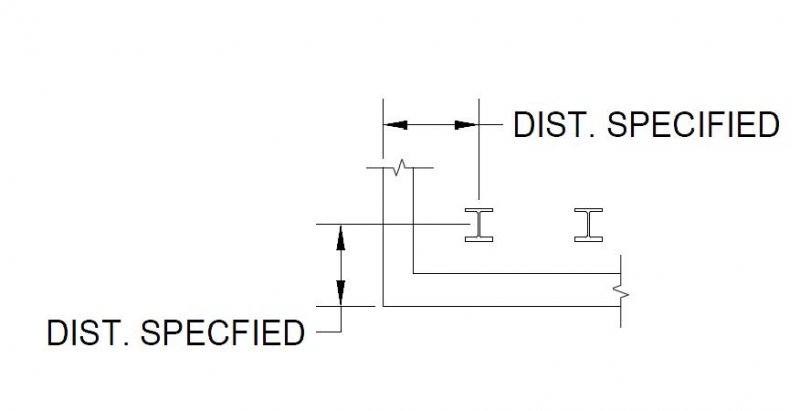

Firligic Posted December 28, 2010 Posted December 28, 2010 i've read this instructions like 1000x times and i dont understand it, can someone help me. Structural Drafting with Autocad.pdfFetching info... pg 8 and before these instructions i was suppose to make a title block which i did already that is 11" x 17" so i am suppose to create a W12 x 152 I-beams i dont understand bullet point #2. i cant picture how it suppose to llook like and how it is placed. thank you for helping Quote
Jack_O'neill Posted December 28, 2010 Posted December 28, 2010 W12 x 152 is a standard structural steel shape, you should be able to find the dimensions for this in the Appendix H your text refers to or just about any steel catalog. Draw it as though it looks like a capital letter "I". All the second bullet point says is that the dimensions for your foundation plan will go to the center of the "I". Once you've laid out your steel columns in the manner specified in the subsequent bullet points, vertical dimensions will run to the midpoints of the vertical section of the "I", and horizontal dimensions will run to the midpoint of the top (or bottom) of the "I". See below: Quote

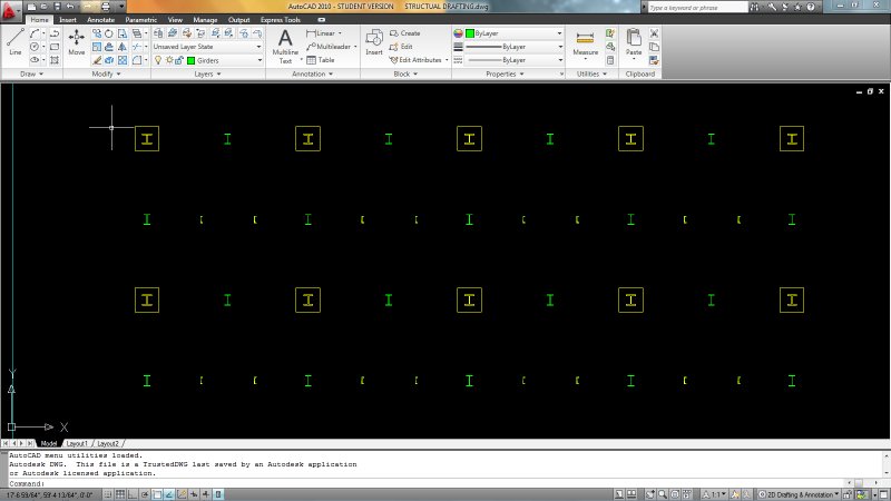

Firligic Posted December 28, 2010 Author Posted December 28, 2010 STRUCTUAL DRAFTING.dwgFetching info... hey guys i think im still dont understand the 20 steel columns- 14 spaced around the build perimeter and six within the interior. arrange these I-beam columns on foundation plan in four evenly spaced rows of five beams each. distance between center beams is 18'-0". and for the overall dimnesions part do i just make the rectangle length of 54' and 72' high? and about bullet point #4: how i make a 16 x 32 x 32 concrete footing? thanks agian guys attached here is my current drawing i know its not correct, but can you please tell me my problem. im pretty sure the measurement is correct. Quote
Firligic Posted December 28, 2010 Author Posted December 28, 2010 STRUCTUAL DRAFTING.dwgFetching info... nevermind i think i got it this is the most recent drawing Quote
nestly Posted December 28, 2010 Posted December 28, 2010 I believe you have your columns spaced at 18 inches, when they should be 18 feet. The concrete footing described is 16 inches tall by 32 inches square, so from the top, you just show that as a 32 inch square centered around the steel column. (BTW, that footing seems far too small for a W12x152 column) here's a quick video showing a top view of what page 8 describes. Quote

Firligic Posted December 29, 2010 Author Posted December 29, 2010 STRUCTUAL DRAFTING.dwgFetching info... heres a screen shot but for better understand i uploaded the drawing hey guys another question from page 8-9 i dont understand how the channel beam suppose to be placed. channel beams rest on the bottom flanges of the griders. with a 1" gap form the web of the girder to the end of the channel.?? need to create pairs of channel beams, 24 of them. my attached file can you guys take another look plz thanks again Quote
nestly Posted December 29, 2010 Posted December 29, 2010 (edited) The W12x152 beams are the vertical columns. The W12x45 girders and C9x20 channels are horizontal and are the support for the 2nd floor/roof. I didn't read the whole thing, but I didn't see where it specified the connection between the W12x45 girders and the vertical columns. The channels rest on the bottom flange of the W12x45 and attach to the web with a 4 inch angle bracket ... *edit* Video re-uploaded Edited February 28, 2012 by nestly Quote
Firligic Posted December 29, 2010 Author Posted December 29, 2010 nestly said: The W12x152 beams are the vertical columns. The W12x45 girders and C9x20 channels are horizontal and are the support for the 2nd floor/roof. I didn't read the whole thing, but I didn't see where it specified the connection between the W12x45 girders and the vertical columns. The channels rest on the bottom flange of the W12x45 and attach to the web with a 4" angle bracket http://screencast.com/t/c2ljZjL0x7 wow that looks awesome, i tihkn i know what im suppose to do now. i never pictured the 3-D version to be like that. now i understand the foundation plan much much more. and you got some really really nice quality on your video's. i should download jing myself to capture stuff cadtutor is like my online tutor thanks so much. i learn much more form you guys than these books they give me Quote

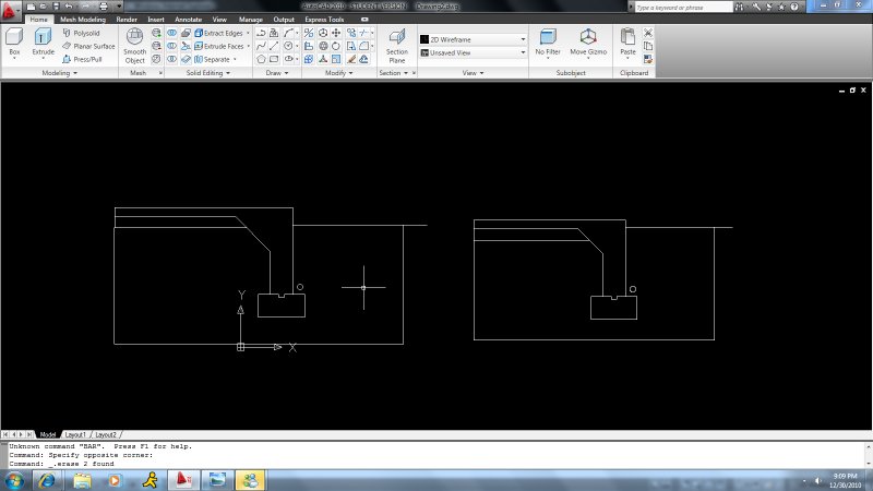

Firligic Posted December 30, 2010 Author Posted December 30, 2010 (edited) this is a online class of penn foster. but yea ill advice your advice about the work sites. well i hope i did the foundation plan correctly. cuz now im stuck on page 11. so what i think i understand is, I am now taking the foundation the i made and making the south elevation with it right? from what i understand this project is in 2-D right, not 3-D?? a keyway?? but here on page 11 its tlaking about elevation. finish grade elevation 292.90, first floor elevation 293.90, second floor elevation 305.19. distance from the top footings to the finish grade is 4'-0". i am so confused. i feel like im doing everything wrong even my foundation plan STRUCTUAL DRAFTING1.dwg Edited December 30, 2010 by Firligic Quote
Jack_O'neill Posted December 30, 2010 Posted December 30, 2010 I think you are missing some key terminology. It's confusing because the same words are commonly used to describe different things. Maybe I can help clear that up a bit. If you are talking about views in a drawing, the "plan" view is as if you were looking straight down from above the building. The foundation "plan" at that point would represent what the building's foundation would look like if you were suspended from a crane looking straight down at it. An exterior "elevation" view is a look at the side of the building as though you were standing on the ground looking at the building. You would create a drawing of just what you see. The "first floor elevation" your text on page 11 refers to is the height of the floor above some known point. This can be sea level, some USGS marker, or any number of other references depending upon the architect. For your purposes at this stage, it doesn't really matter what the reference is. Since your first floor is at 293.90, and the second floor is at 305.19, subtract the smaller number from the larger one, and you find that your second floor is 11.29 feet above the first floor. You will eventually create a "section" view. This view will be as if you had sliced the building at some point and were looking inside it. These are sometimes called "cross-sections". You will also do sections for details of walls, windows, and just about everything that goes into a building where clarification is needed on how it's built. I would very much suggest you get hold of this book: Construction Drawings and Details for Interiors: Basic Skills by Kilmer and Kilmer. It's available on Amazon both in hardcopy and a Kindle version. They have a reader app for PC's that is a free download so you can purchase Kindle books and read them on your pc without having to have a Kindle, by the way. There may even be one or something like it in your local public library or bookstore. Any book on basic drafting will have the information you need. I suggested this one simply because I know it's easily obtainable. You may find drafting books in used bookstores, especially if you live near a college town. Many of the older texts will talk about papers and pencils and the tools of manual drafting, but don't let that put you off the book. The information about how to dimension and how create and label the various views required has not changed much. Most of the terminology is the same, with a few exceptions. There is a common misconception that is spreading throughout many of the vocational and technical schools and even many colleges that learning how to use AutoCAD is the be all and end all of drafting. Based solely on the portion of the text you have provided, I get the impression that this course is either built on that assumption, or that they have assumed that anyone taking this course is already familiar with drafting and/or blueprint reading. Being proficient in AutoCAD without basic drafting skills is like knowing how to draw with a pencil, but never having learned to write. Please don't misunderstand me, I'm not criticizing you at all. No one is born knowing how to do this stuff and unless someone teaches you (or you grab a book and learn it yourself) you can't possibly know what all these things mean. This is the source of your confusion. If you can get your hands on a drafting manual of some sort, a few hours of reading will clear up much of the trouble you are experiencing. As an added bonus, you'll have the book there to refer to in future when you have one of those "now what was that again?" moments. You'll be able to grab the book, hit the index and have an "oh yeah, I remember now" moment. Combine that with the help you'll find here and you'll soon have a handle on it. Quote
