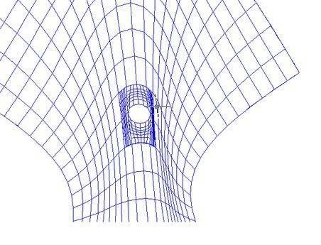

shift1313 Posted September 27, 2008 Posted September 27, 2008 im not sure if you can trim or not. I havent tried it yet but i would imagine trim. Quote
shift1313 Posted September 27, 2008 Posted September 27, 2008 the computer im sitting at only has 05 on it but i was curious so i started playing with it. I wasnt able to subtract or cut anything using 05 but i did explode the mesh surface, delete a few panels where i wanted the hole and created a surface patch for the hole. The only problem is now each facet is a single object. Quote

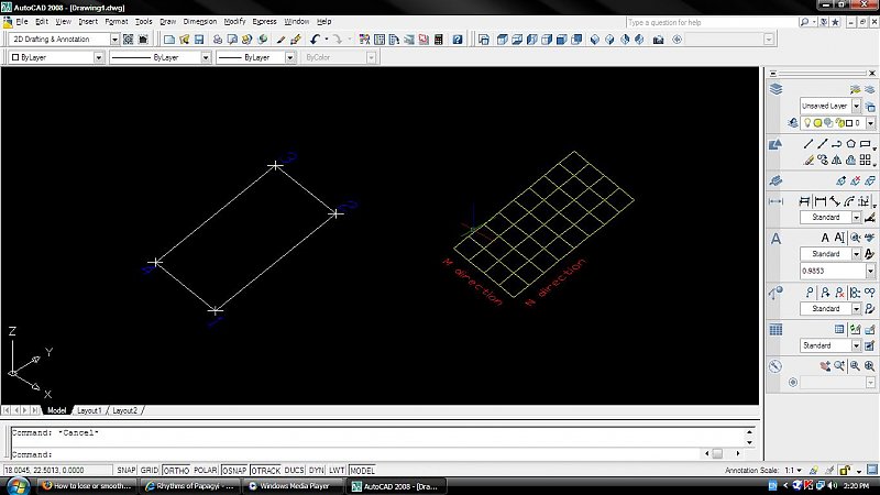

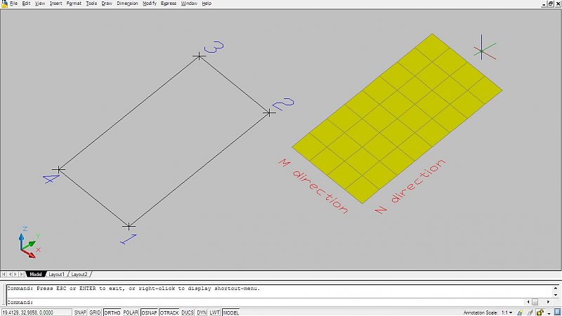

papagyi Posted December 11, 2008 Posted December 11, 2008 Sorry fri! I said surftab1&2 for mesh modeling (edgesurf,revsurf,tabsurf,rulesurf)! you means 3d mesh that can be control with surfu,surfv to smooth! Now i will show how to make 3d mesh for basic!Then you can try yourself more! First you need to predefine points as your favorite model to draw mesh! Points can place any location! ... Command: 3d enter Enter an option [box/Cone/......../Wedge]: m enter specify first corner point of mesh: point 1(end point snap) specify second corner point of mesh: point 2 specify third corner point of mesh: point 3 specify fourth corner point of mesh: point 4 Enter mesh size in the M direction : 5 enter Enter mesh size in the N direction : 9 enter Now you can see according attach image!:) Quote
autocad_designer08 Posted December 11, 2008 Posted December 11, 2008 thanks master phyo for the immediate reply! i have just tried it and it really worked! now, ill try to experiment on curves! Good day! Quote

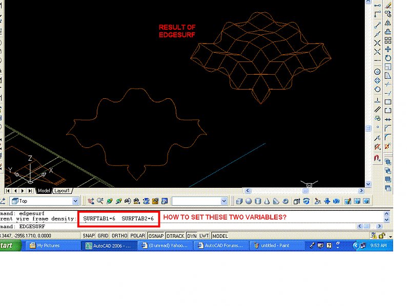

autocad_designer08 Posted December 12, 2008 Posted December 12, 2008 hello master phyo! i have already tried all the surfaces in creating mesh according to default surftabs and that of what you have shared to me yesterday... my problem now is on how to make a smooth surface using edgesurf command. according to some post here dated 2006, the surftab1 and surftab2 variables should be set to a higher value before applying edgesurf command... how? here's a picture of what im trying to point out... Quote
papagyi Posted December 12, 2008 Posted December 12, 2008 Welcome to surface user fri! Edgesurf command is pretty cool!You must preset higher value to surftab1& surftab2 to get smooth modeling!But don't use too much higher value,if not necessary!It can be heavy to drawing & use big memory amount! Eg. for your attach image (surftab1&2 -16x16 or 24x24) type "surftab1" enter "24" enter type "surftab2" enter "24" enter! Quote
shift1313 Posted December 12, 2008 Posted December 12, 2008 hello master phyo! i have already tried all the surfaces in creating mesh according to default surftabs and that of what you have shared to me yesterday... my problem now is on how to make a smooth surface using edgesurf command. according to some post here dated 2006, the surftab1 and surftab2 variables should be set to a higher value before applying edgesurf command... how? here's a picture of what im trying to point out... [ATTACH]8748[/ATTACH] your default value for surftab is 6. if you look at your surface you will see a 6x6 grid. setting the number higher correlates to the number of "grids" in a certain direction. For surfaces they are usually refered to as M and N direction or in the case of edge surf and a few others, surftab1 and 2. set it to 20 or 30 each and see if your shape is close enough. because of your splines, im affraid you will need this set pretty high to retain that small arc. my guess is close to 100 will be a good fit. Quote

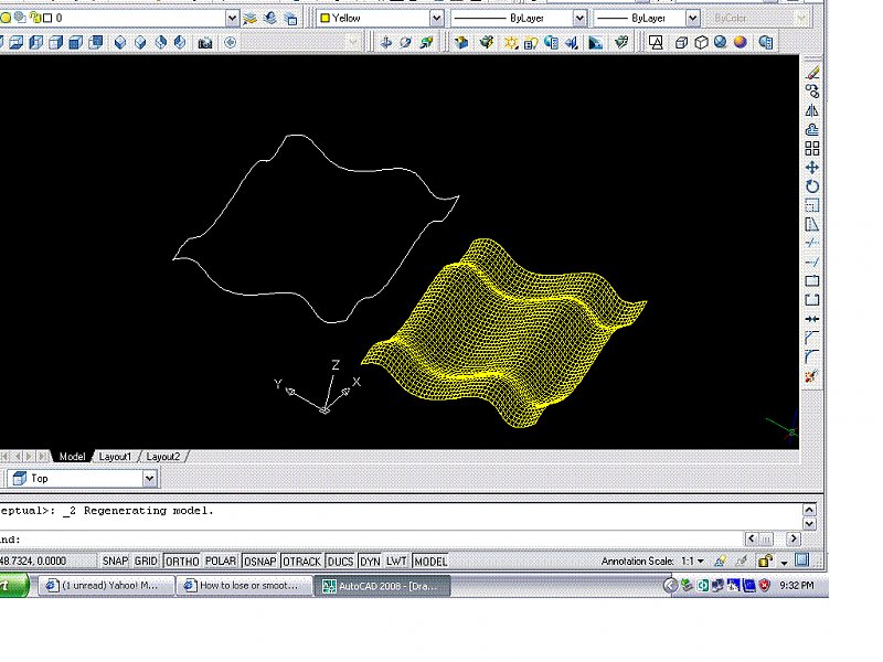

autocad_designer08 Posted December 12, 2008 Posted December 12, 2008 to:arjun_samar first, maayong gabii diha nimo! i bet un understand bisaya.. nwe, for a basic surface: first you have 2 define ur contour. then set your surftab1 & 2 variables to a higher value n order 4u 2 have a smooth surface. (thanks to master papagyi & master shift1313 for this hint). in d commad line: type surftab1 enter 50 enter surftab2 enter 50 enter now, at d draw menu>modeling>meshes select edgesurf. click on the 4 spline. u must have something similar to the image below. try also the other surface command... just explore! Quote
