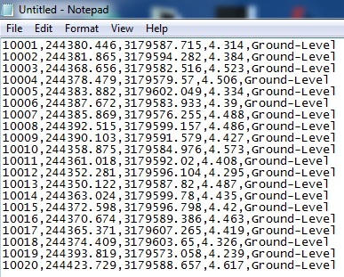

Please find the attached it has Pointid or Sl. No, Easting, Northing, Elevation and Code.
Some can like this even without the Sl.No. will be great.
Thanks.

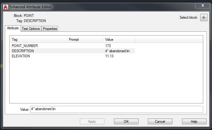

What is need to include these attribute information?
