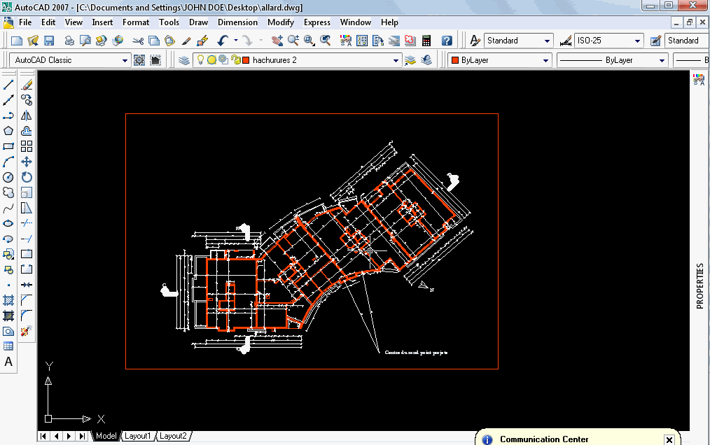

This is the drawing to plot: for a 1/100 scale, it's size is slightly smaller than an AI paper format.

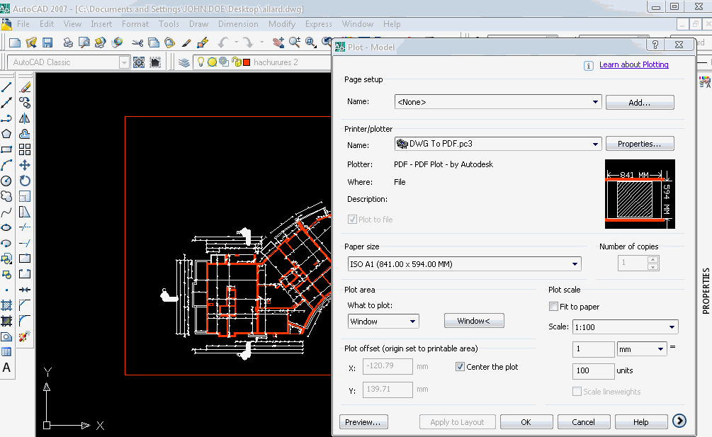

These are the settings to plot.

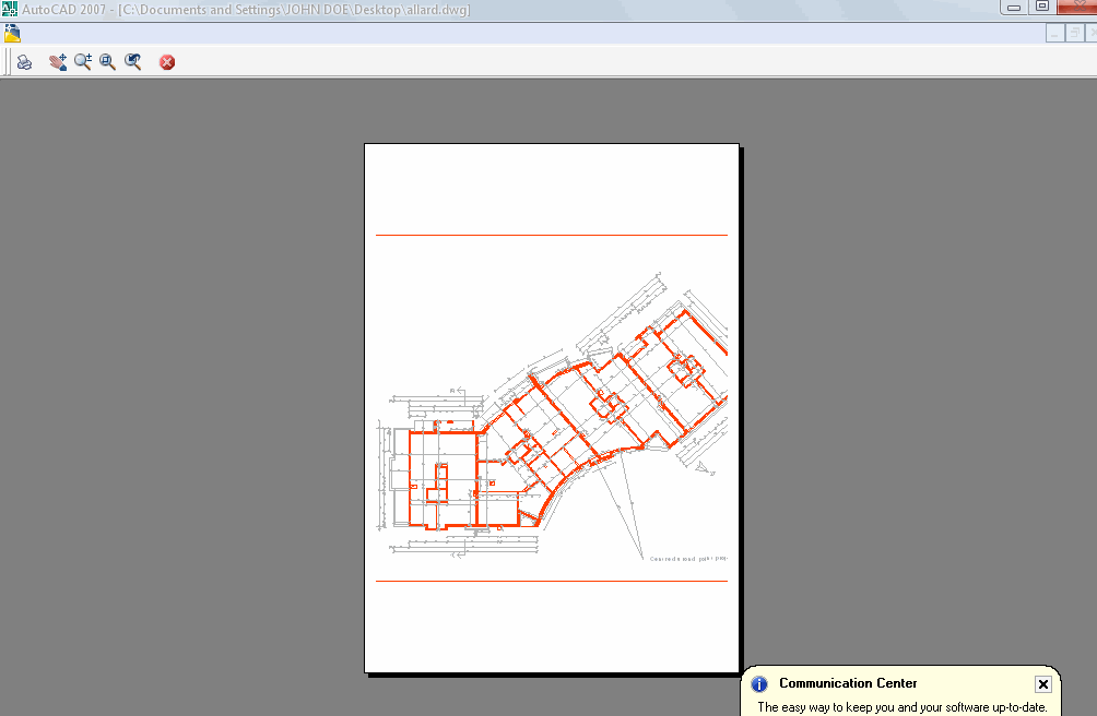

And this is the preview window: autocad has rotated my drawing and now it doesn't fit into the A1 format (unless i rotate the actual drawing myself and start the same plotting processus, and then it will fit)
Click the little arrow button in the lower right corner of the plot dialog. This will expand the dialog and give you more options. One of those options is "Drawing Orientation". Change it to "Landscape".

HEY Thanks !
It worked.
Damn hidden buttons, ha ha.
I should have been more clear in my question re: orientation as I too was thinking portrait vs. landscape. Cad64 nailed it though. Nice. :)
