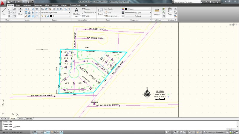

Firligic Posted December 22, 2010 Author Posted December 22, 2010 I am 95% done with this project, just need to fix a few things. my trees are not in the right place yet. and i didnt do the total length of the boundary. i hope this thread will help others in the future. this is how my look like. thank you everyone for answering my questions Quote
ReMark Posted December 22, 2010 Posted December 22, 2010 (edited) Get rid of the grid and either use a black background so the yellow lines are more easily seen or change that layer's color to black. The image is rather small. Attempting to compare your drawing to the copy I have is going to be a bit of a problem. You have a title block and border right? Edited December 22, 2010 by ReMark Quote
