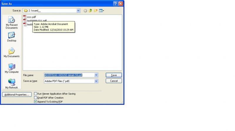

With Acroplot, this Saveas Dialog box comes up. But not the DWG to PDF.

with Acroplot:
PLOT goes directly to the saveas dialog
PUBLISH goes through the publish dialog box, then when you click the Publish button, it goes to the Saveas dialog. It repeatedly goes to the Saveas for every layout where I just double click the file I want to append to (also ensuring that the "Append to Existing PDF" is checked.
