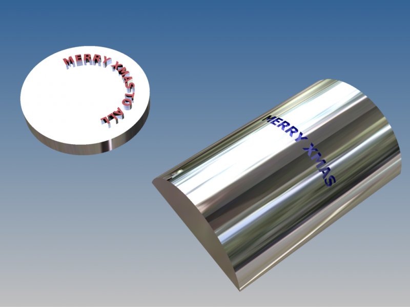

Hopinc Posted December 16, 2010 Posted December 16, 2010 (edited) Hi Guys, You don't actually need to offset a plane at all. The two attached examples were created by sketching directly on top of the "puck" and by sketching on a tangential plane to the arc. You can dimensional drive your text, or use constraints, to locate it. If you wish to place text, say with centre justification, right click on it and turn off the "text box." You will then be able to see the justification point of your text and use this for positioning. On the right hand part the emboss has been wrapped to the surface. One of the options that Steve mentions in his post. Another you may not notice at first is that you can select a different colour to the base part for your emboss, if you wish. There is one caveat with text - you will not be able to emboss all of them. Certain fonts will generate intersection errors. You will have to use trial and error to select a successful one. Regads, Dave Edited December 17, 2010 by Hopinc Quote

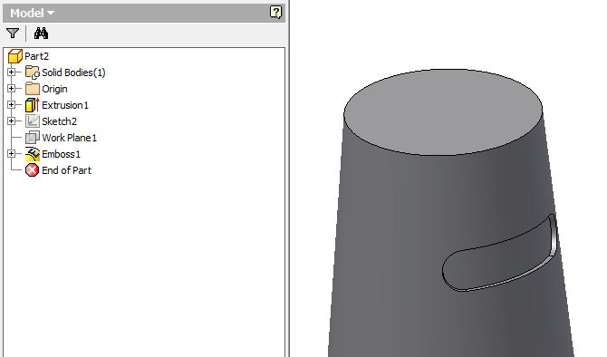

Inventor Posted December 17, 2010 Posted December 17, 2010 Oh Sorry i didn't see that bit must have missed a thread. It will work on a conical face by the way, you have to create the work plane and sketch tangent to the conic. It is only double curvature it cannot handle (as you say oval etc) but a conic is only curved in one direction so it is possible. Regards Quote
Hopinc Posted December 17, 2010 Posted December 17, 2010 Sorry Inventor, but I had already covered that too: It does have it's shortcomings though, it will not wrap to an oval surface, planar,cylindrical, conical yes, ovoidal no. The one thing no one has yet mentioned is that the emboss sketch must NOT exceed the width of the projected surface you are working on. So if you want to wrap an emboss totally round an object it has to be done in two stages. Regards, Dave Quote

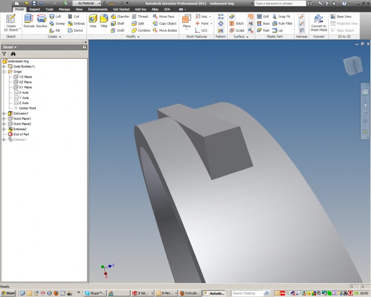

abishop Posted December 17, 2010 Author Posted December 17, 2010 This is what i am trying to do! Quote
abishop Posted December 17, 2010 Author Posted December 17, 2010 can i add draft? It is only coming out .012. I did my first letter and it worked! I had to sketch the letter. THANKS A TON! Andy B Quote

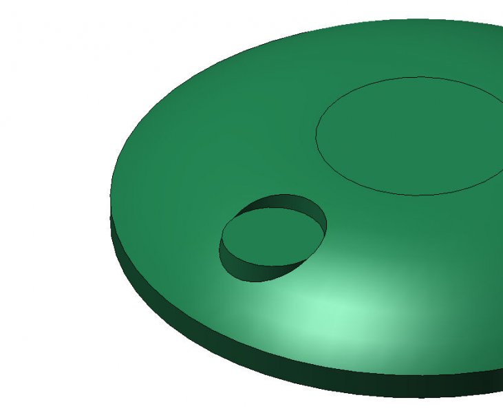

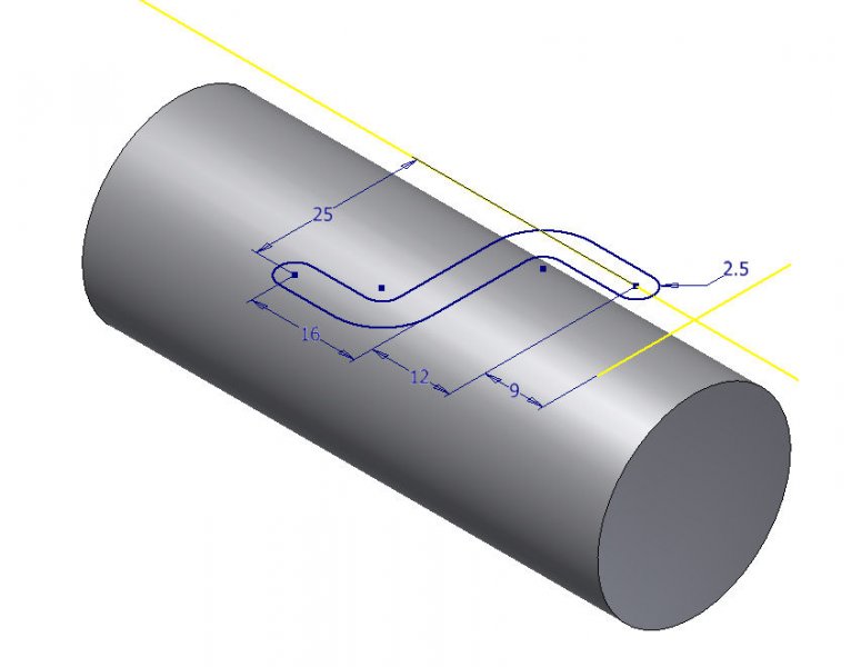

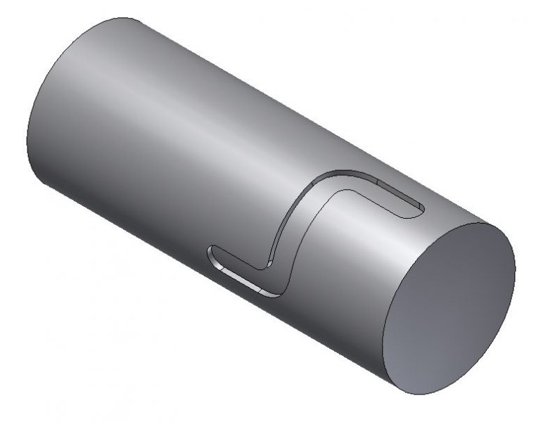

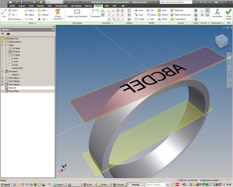

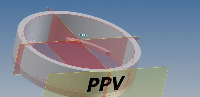

Hopinc Posted December 17, 2010 Posted December 17, 2010 Unfortunately no. Inventor does not yet support a wrap to face function that can have draft. There is a function within emboss (from a plane) where you can set a draft angle, and it can be useful - see image two. But it will not work in this instance. What version of Inventor are you using. I have a model of your ring, which you can re-size to your requirements if you wish, and be able to see how I have created it using text, not sketched individual letters. One thing that you might come across is shown in the first image, where the text is mirrored. To correct this right click on the sketch plane and select "Flip Normal." Regards, Dave Quote
