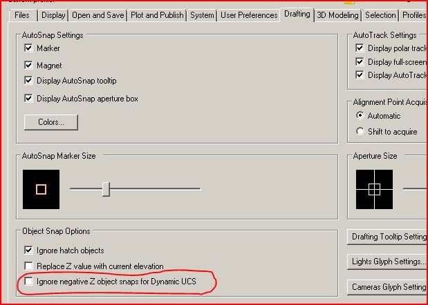

I'm having the same problems with Isometric tangents. Sometimes it refuses to snap at all. Sometimes it snaps to completely the wrong place. Sometimes it appears to snap to the right place, but a subsequent operation such as trim shows that the snap hasn't worked (e.g. refuses to trim because no intersection, or leaves artifacts after the trim).
I can't convert groups of connecting lines to polylines either. This may again be because they don't truly intersect.
I'm trying to do a City & Guilds assignment, so I can't draw in 3D and choose a view.
What would be very useful would be a list of which tools work in isometric, which don't, and what workarounds exist.

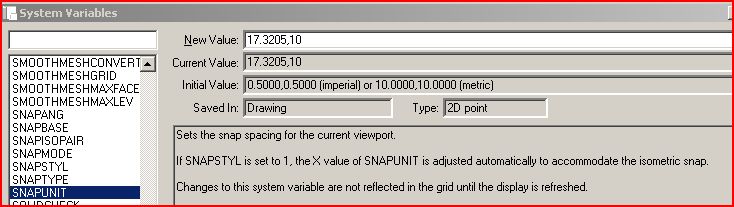

You might want to investigate your SNAPISO setting, and see if changing it helps at all.
SNAPSTYL set to 1 (Isometric).
Looking at the sytem variable SNAPUNIT, it looks like you might want to do a regen before trying to use isometric snaps in your drawing.

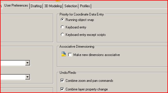

Prioritize OSNAPS also for data entry.

I would suggest you try these values, the important one is turn off the ignore Z value for dynamic UCS, and turn on your Osnap magnet.
