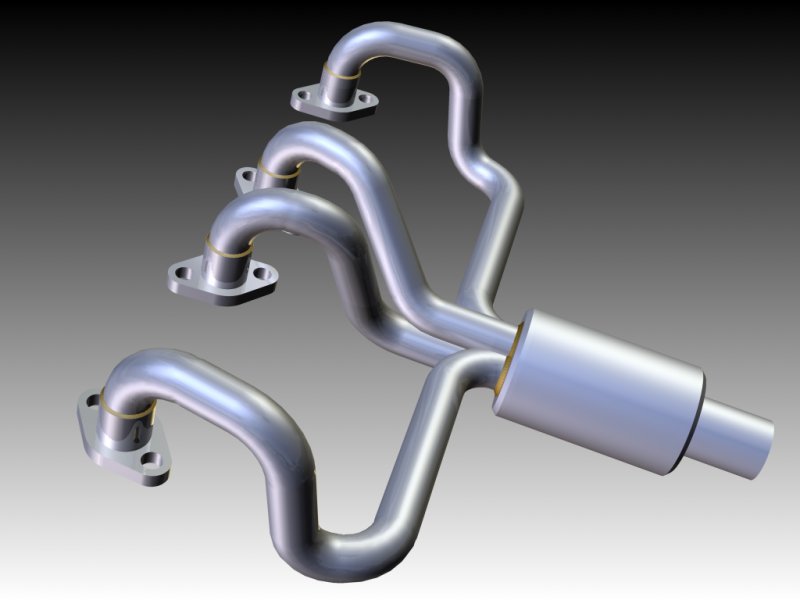

Hopinc Posted December 15, 2010 Share Posted December 15, 2010 Hi, Here is an example of modelling using 3D sketches - creating the pipes would be impossible any other way. Regards, Dave Quote Link to comment Share on other sites More sharing options...
vertical horizons Posted December 20, 2010 Author Share Posted December 20, 2010 Hopinc - That is really amazing. Quote Link to comment Share on other sites More sharing options...
Hopinc Posted December 20, 2010 Share Posted December 20, 2010 Thanks for the appreciation, but actually it is nothing really special. It is just a little 3D sketching and sweeping, together with an assembly of parts and some weldments thrown in. Believe me when I say that it is nothing you could not do yourself. Check out the internet, there are many good video's on using Inventor. I think it is much better to see it done once, than read it in a book or help page, and then struggle through the process yourself. Good luck. Regards, Dave Quote Link to comment Share on other sites More sharing options...

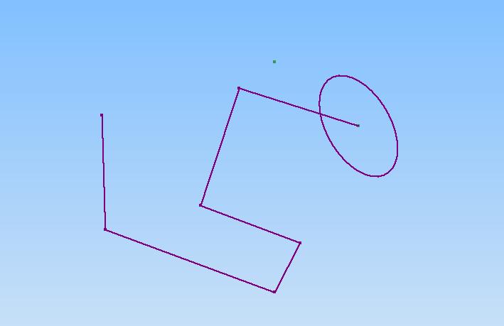

Aboodios Posted December 20, 2010 Share Posted December 20, 2010 Hi vertical horizons, basically the difference between them is that in 2D Sketch you have to choose a plane (XY etc) on which you want to draw and in 3D you don't have to choose a plane you can sketch in 3-Dimensions. As you can see in the attachment, I have created the circle on the XY plane using 2D Sketch, and then I used the 3D sketch to sketch the lines in the Isometric view. Kind Regards, Aboodios. Quote Link to comment Share on other sites More sharing options...

Aboodios Posted December 20, 2010 Share Posted December 20, 2010 Awesome, thanks for the info Hopinc. Quote Link to comment Share on other sites More sharing options...
