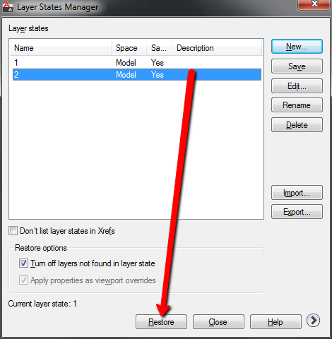

Have you tried to switch layer states using layer states manager?
Activate your viewport, type LAYERSTATES then enter to open it. Choose your layer state, then click restore.
Be sure the system variable Visretain is set to 1, see if that helps.
Thanks mate,
Your a life saver. I was manually picking the states in the ribbon!
