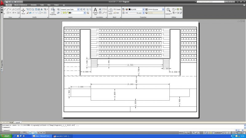

Hi all - hope you are all ready for christmas!! I am adding the correct layout of our dugouts, which we had changed recently, to an existing drawing and when I add in the linear dimensions it is showing the measurements vertically and not horizontally - I have had a look in the dimstyle menu and everything is set to horizontal!! can't figure it out. I am either missing something completely obvious or just plain tired but I would put that down to manflu lol

Is your UCS rotated 90degrees relative to the WCS? Is your view rotated 90degrees relative to the UCS?
perhaps an aligned dimension may be better for this situation, how about posting a screen shot? should be smaller and give us the same amount of detail to clarify your question.

I will hold my hands up and say I had a total 'doh' moment!! When I came to this drawing today I thought to myself 'What was I on about yesterday??? I just need to change the text alignment to ISO standard in the dimstyle!!'
so my apologies for wasting anybodies time!! a screeshot anyway -
