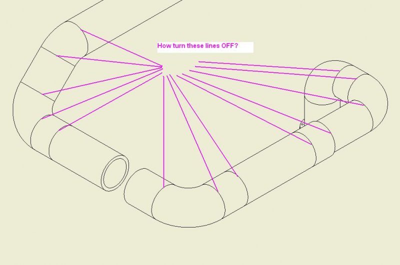

Hi Guys,
How do i turn-OFF the tangent/intersection line in .idw?
I have checked on the Drawing View dialog box the options Interference Edges & Tangent Edges are unchecked.
How is that modeled? Doesn't look like some of those lines should be there in the first place unless each of those is a separate part - and towards the right side it looks like a change in pipe size.
From the looks of that and assuming you do have tangent edges turned off - you have part edges. You wil have to right click on those to turn off the visibility. I would leave that one on the right side visible where there appears to be a change in size.
Hi JD,
Sorry for the late reply.
They were modeled using the Design>Insert Frame. Yes, you are right there are two pipe size 16" & 18" they were rap with blankets.
1. I created a 2D Sketch as a guide for my 3D sketch then, I create 3D sketch out of the 2D sketch points. Save file as ,ipt.
2. Open new assembly and place the created .ipt and then, invoke the Design>Insert Frame.
BTW, there are multiple line segments along it.
Hi CAnnondale,
Don't forget their is a 'Merge' option on the insert frame member dialogue box if you wish to have one continous section rather than multiple sections.
Regards
Hi Inventro,
Thanks for that info. I will look onto it once i am in the office.
