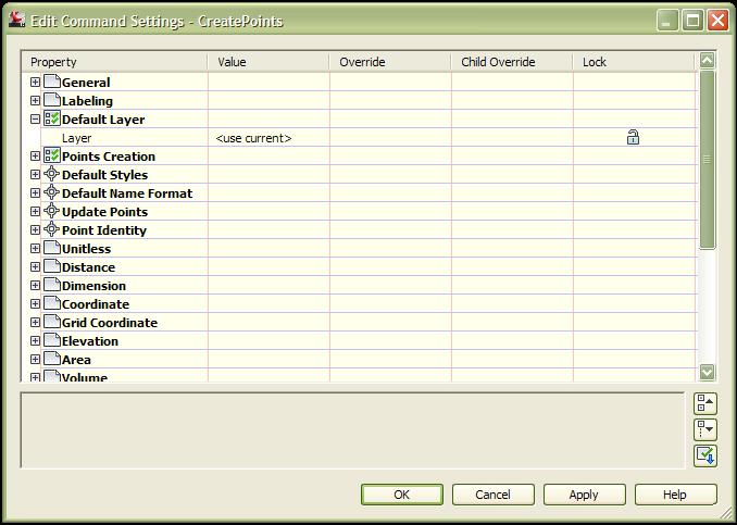

I believe this is the default setting when importing points from a txt file to Civil they go to layer 0 how do I change it so they import on to the current layer?
Thanks,
Set the layer you want the points on current prior to importing them
Actually I was able to find where you need to change the setting is in Edit Command Settings, the default for importing points is layer 0 no matter what layer you are on.
to
