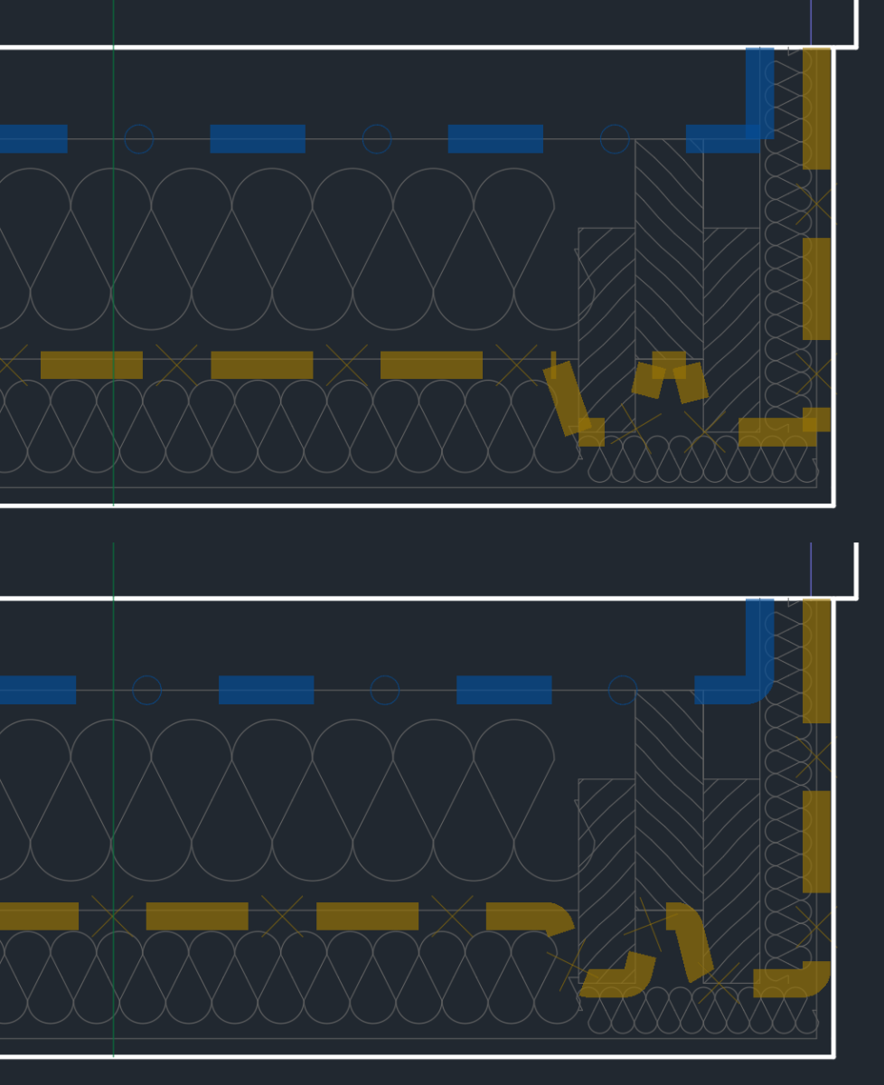

How Can I Draw A Pline Like This ??
Here we go. The one on top is during the pline command and the one below after entering. There has to be some sort of variable that controls this appearance.

I get a nice clean continous PLINE when I draw one with a width.....
The only thing I've found in the help file thus far is this:
Typically, the intersections of adjacent wide polyline segments are beveled. No beveling is performed for nontangent arc segments or very acute angles or when a dot-dash linetype is used.
looks like your top lines a single polyline whereas the lower ones multiple polylines.
in command bar type pedit
then select one of them, if it says
"Object selected is not a polyline
Do you want to turn it into one? "
Press return, and then enter "J" for join,
select the other lines and Right click once,
then enter "W" for width and enter the
width value and press enter twice to exit the
command.
skipsophrenic is correct.. its either you use pedit... or just manually fillet each corner. in this way, you can choose which kind of corner you want.
draw your Pline with default linewieght, type "trace" command set trace at 3", trace each segment of Pline start end with the trace and you will get that effect

A different approach with a different result for the same problem:
I also want to create Miter corners for complex linetypes and sadly I can’t, but I can apply Rounded corners at least.
If you set the radius of the corners of the polyline to HALF of the Global Width, the corners become rounded.
I got the idea from eldon’s reply.
