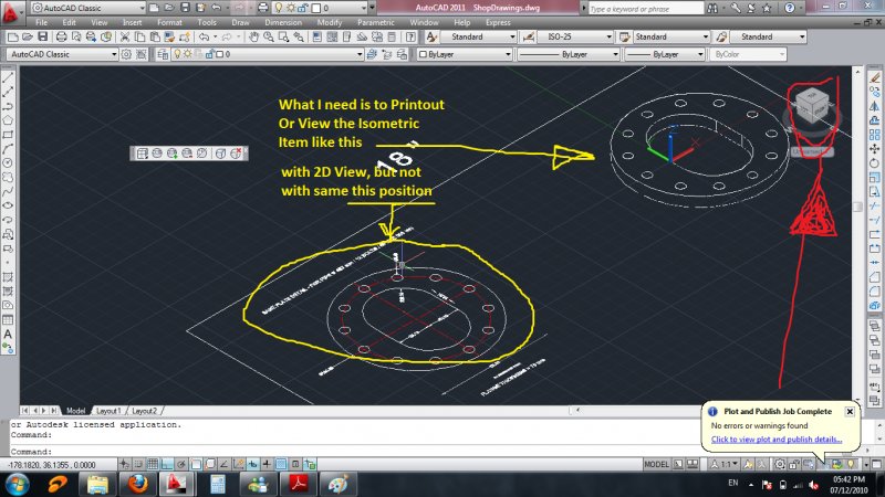

View Isometric 3D and Its 2D Views( Top, Elevation and front View) !!
How can I view the Isometric Item with its Views ( Top. Elevation and Front View )
in the same paper, or in same drawing file ...
, thanks

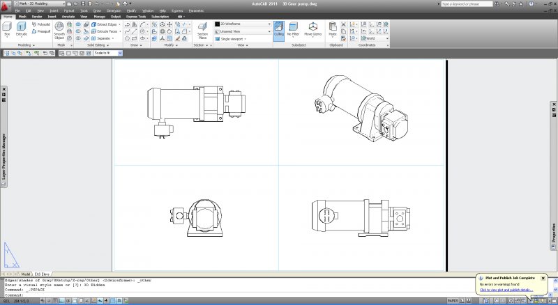

This multiview of a gear pump was done very quickly in a layout. The visual style was 3D Hidden.
ShopDrawings.dwg
the dwg filethe dwg file

exactly this wat i want ...
could tell us step by step to things like that
[ATTACH]25031[/ATTACH]
I went into a layout and used the Viewports command. My settings were Four: Equal, Setup: 3D and Visual Style: 3D Hidden. I elected to use the "Fit" option for my viewports so all four of them filled the page.
In the example I posted I selected my printer and page size using the Page Setup Manager.
Note: This is just a very quick and dirty way of getting what appears to be 2D views. They are not truely 2D. For that you would have to use a different method. Flatshot is one option. Another option is SolProf. Yet a third option is the combination commands of SolView and SolDraw.
