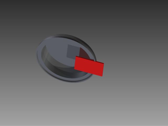

hesy87 Posted December 7, 2010 Posted December 7, 2010 I am trying to remove a section from a lip. In autocad I would normally use a boolean operation to take away the red box from the black lid. This is not possible in inventor, does anyone have any suggestions as to the easiest way to perform the same function. Quote

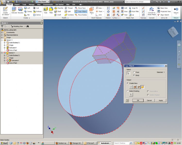

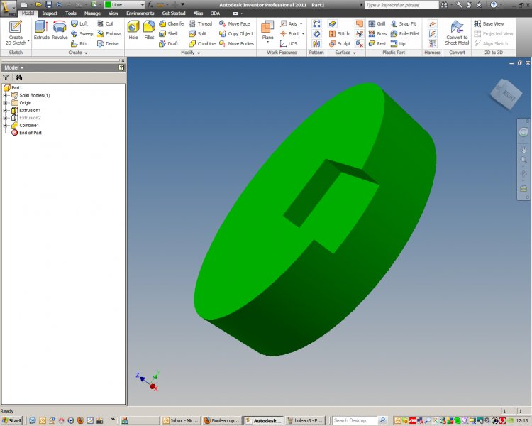

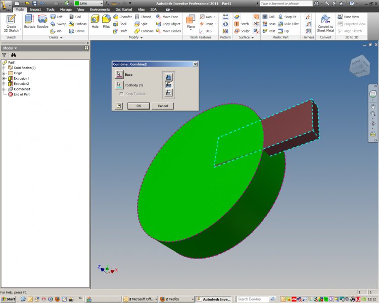

Hopinc Posted December 10, 2010 Posted December 10, 2010 (edited) Hello, Yes, you can do this in Inventor. Depending on how you created your two parts: 1) If you have two parts in an assembly you need to select edit for the part you want to modify, then copy object (tick solid) for the part you want to use as a cutter. Select combine, choosing your base part and tool body. Now you have to decide whether to retain the cutting part or delete it. If you choose to delete the cutting part it does not mean that it will disappear from the assembly. Select OK, job done. 2) If you have created two seperate parts in one model file, all you have to do is select combine, select base part and toolbody, pick cut, hit OK, job done. Please note that the cutter part will be asborbed. Pictures 1 & 2 show the assembly version. In image 1 I have alreay selected the ellipse part to edit and then "copy object." Images 3 & 4 show the boolean cut of the two parts created in one method. I hope this answers your question. Regards, Dave Edited December 10, 2010 by Hopinc Quote
