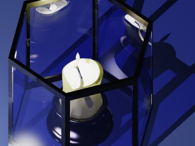

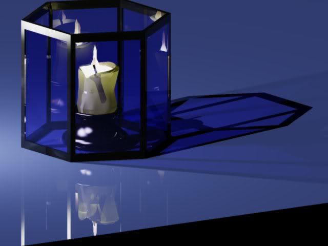

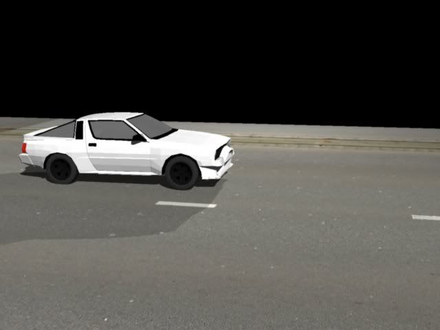

shift1313 Posted September 22, 2008 Posted September 22, 2008 i just downloaded the trial version and ive never really done rendering in the past so this is with very little experience. Quote
shift1313 Posted September 22, 2008 Posted September 22, 2008 oh yeah, those were done at medium quality Quote
skipsophrenic Posted September 22, 2008 Posted September 22, 2008 'MEDIUM?????? er maybe if it weren't for the cost i'd re-upgrade to '09 afterall! Quote
Cad64 Posted September 22, 2008 Posted September 22, 2008 2007 uses the Mental Ray 3.4 rendering engine. 2009 uses the Mental Ray 3.6 rendering engine. Here are some of the improvements made to lighting and materials in 2008: http://autodesk.blogs.com/between_the_lines/2007/02/autocad_2008_le.html If you really want to see the difference between '07 and '09, download the free 30 day trial of 2009. Try before you buy. :wink: Quote
shift1313 Posted September 22, 2008 Posted September 22, 2008 'MEDIUM?????? er maybe if it weren't for the cost i'd re-upgrade to '09 afterall! and they took no time at all to render either. I use 07 at work currently and i think the user interface for the rendering in 09 is a little more friendly. but like i said i havent played with rendering much. Quote
