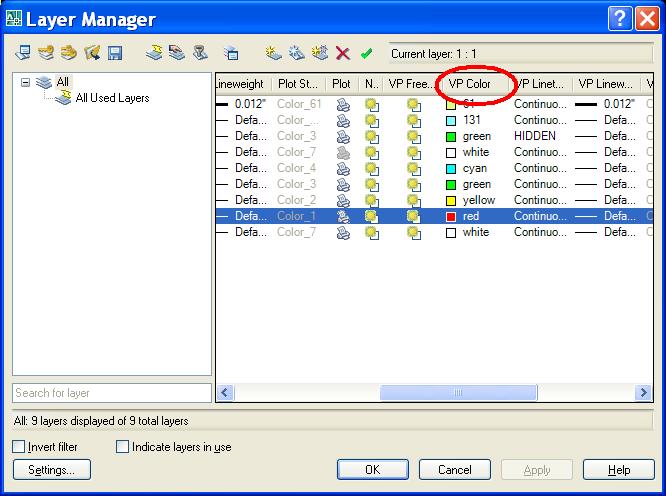

I know about the override but that's going to change the duct/pipe in model space and I don't want to do that. I know I can toggle the colors between plots but I thought there was a way to create a layout tab and select the viewport while staying in paperspace and change the colors of the duct/pipe without actually changing them in model space.
Read the column heading. You're changing the VP (Viewport) color. That's why they call it an OVERRIDE.
Oh ye of so little faith. From your own AutoCAD Help file re: Viewport Overrides.
"You can display objects differently by setting property overrides for color, linetype, lineweight, and plot style and apply them to individual layout viewports.
Using property overrides is an efficient way for displaying objects with different property settings in individual viewports without changing their ByLayer or ByBlock properties. For example, objects can be made to display more prominently by changing their color."
