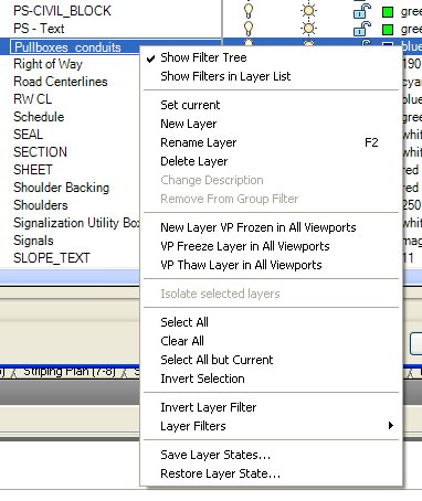

Bertdorf3 Posted November 10, 2011 Posted November 10, 2011 I have a situation frustrating me. I have alwasy been able to go to Layer Properties, right click a layer, then from the menu select "Isolate Selected Layer"... but now I am on C3D 2011 and that option is now greyed out! I cannot seem to find a solution. Anyone have an idea as how to restore this option? I have been ACADing for 5 years, started with ACAD 2000... Quote
pman860507 Posted November 11, 2011 Posted November 11, 2011 I use a button. with this macro to do mine. ^C^CLL;F;*;; Quote
Bertdorf3 Posted November 14, 2011 Posted November 14, 2011 I use a button. with this macro to do mine. ^C^CLL;F;*;; That appears to be a macro for [FILLET] Quote
pman860507 Posted November 14, 2011 Posted November 14, 2011 That appears to be a macro for [FILLET] not for i. LL does the layer command for me and then f to freeze and * for all. Quote
alanjt Posted November 14, 2011 Posted November 14, 2011 You should use full command names instead of an alias. You never know when you might change LL to be something else or AutoCAD assigns that syntax to another command name. For instance, in Civil 3D, "LL" is a command that converts Lat/Long to an XYZ point and it's NOT defined in the PGP file - cannot be defined as anything else. Quote
Bertdorf3 Posted November 14, 2011 Posted November 14, 2011 Thanks for the suggestions. I certainly can work around getting the layers to freeze in various ways, my main question I guess was if anyone knows how to get the option on the menu un-greyed and available again... co-workers here have it as an available option... I was thinking maybe I had a variable turned off or something. Quote
