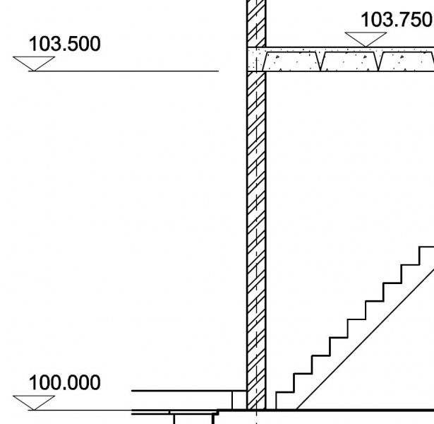

Is there a possibility to place ordinate dimensions in ACAD in the same easy way as you do it in Microstation?
I mean placing ordinate dimensions without messing around with the UCS or things like that to move your 0,0 coord. and place a cell/block at the end of the dimension line. (like the arrow in the att)
For those who don't know MS: you select ordinate dimension and enter the base value (ie 100 like in the attachement), then you just pick the basepoint, the direction of the axis you want to dimension and the location of the other points.
Thanks in advance for all the help.
Dompie
Somewhere on this site or some of the other lisp repositories are a couple of routines for doing what you want. I can't remember the exact name of the routine, but it has something to do with "datum dimensions". I used it a lot years ago when most of my work was mechanical, but haven't used it much since. I'll see if I can find it, and if I do I'll post a link. You may find it before I do though, headed out the door right now.
This is not exactly the routine I was looking for, but it might get you started. If you know lisp programming, you can probably make this do what you want with some modifications:

I stumbled across another lisp routine that will do what you want (i.e. - place elevation levels). It's called Level.lsp and can be downloaded, along with some accompanying files, at the Cadalyst website. The routine was written by Neil Foden and submitted 22-Feb-2010. Look for Tip# 3354 - Place elevation levels.
www.cadalyst.com
It can be found in the Cad Tips section.
A more definitive link:
http://cadtips.cadalyst.com/attributed-blocks/place-elevation-levels

One option is to simply go ahead and place your ordinate dimension while in the WCS 0,0.
Afterwards, select your dimensions to display the grips, hot grip the dimension origin and drag them to where they need to be.
