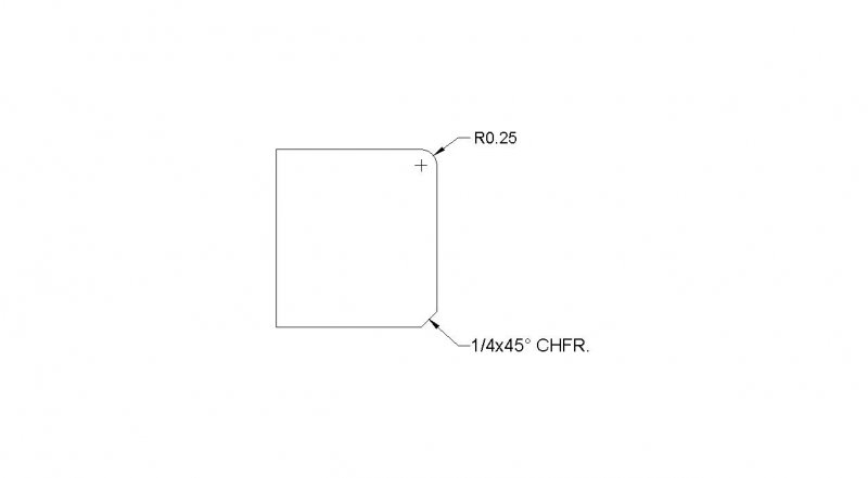

ReMark Posted November 29, 2010 Share Posted November 29, 2010 (edited) The dimensions can be added to both the fillets and the chamfers just as you would any other dimensions. Fillets ex. - 1/8R Chamfer ex. - 1/8x45 deg. This is how I would do it (a round and a chamfer). A fillet is a rounded interior corner while a round is a rounded exterior corner. I rarely hear the term "round" as many people tend to use the term fillet interchangeably. Edited November 29, 2010 by ReMark Quote Link to comment Share on other sites More sharing options...
Kevin10th Posted November 29, 2010 Author Share Posted November 29, 2010 The dimensions can be added to both the fillets and the chamfers just as you would any other dimensions. Fillets ex. - 1/8R Chamfer ex. - 1/8x45 deg. This is how I would do it (a round and a chamfer). A fillet is a rounded interior corner while a round is a rounded exterior corner. I rarely hear the term "round" as many people tend to use the term fillet interchangeably. [ATTACH]24854[/ATTACH] How could you do that? Can you tell me the steps to do it? Quote Link to comment Share on other sites More sharing options...
ReMark Posted November 29, 2010 Share Posted November 29, 2010 How can I do what? I just used the Dimension > Radius for the fillet/round and a leader with text for the chamfer. Quote Link to comment Share on other sites More sharing options...
Kevin10th Posted November 29, 2010 Author Share Posted November 29, 2010 I'd like to ask how you make the dimension for the fillet before. I did the way like you'd posted and it didn't work. Perhaps it won't give any dimensions for 3D ones, will it? Quote Link to comment Share on other sites More sharing options...
ReMark Posted November 29, 2010 Share Posted November 29, 2010 I wasn't aware that you were doing this in 3D. That being the case you may well have to use a leader and type the text in yourself. As a matter of practice I usually do not dimension 3D objects themselves. Note: If you try to use Dimension > Radius on a 3D object AutoCAD will return the following: Object selected is not a circle or arc. Quote Link to comment Share on other sites More sharing options...
