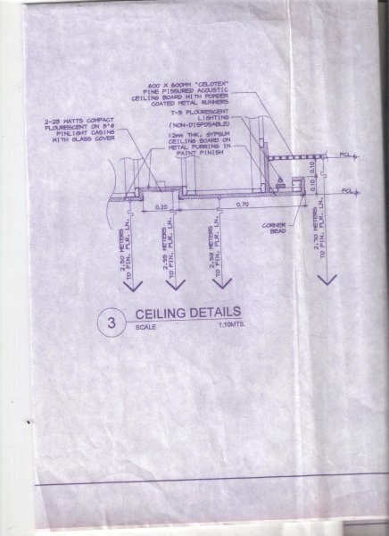

bluepepper Posted January 12, 2011 Author Posted January 12, 2011 Hi, sorry for not replying for a long time and resurrecting the thread but uhm to clarify things, The attached images below are from the same paper. As you can see, not all lines are dimensioned and both drawings are scaled differently. How would I go about in drawing this in AutoCAD? What should my Drawing Units (ie Insertion Scale) be? etc Quote
ReMark Posted January 12, 2011 Posted January 12, 2011 I would draw them from scratch (no jpg, or bmp or pfd) and at full size in model space. That is where I would start. Forget about dimensioning and text until the objects themselves are fully drawn. Quote
bluepepper Posted January 12, 2011 Author Posted January 12, 2011 So using an architect's scale to measure the un-dimensioned(?) lines is correct? And so err.. for example, If I were to draw a single glass panel at full size in model space I would input it as 0.97 x 2.20? I R Confused Quote
ccowgill Posted January 12, 2011 Posted January 12, 2011 I'd use Architectural units that way you can enter it in feet and inches (11.64" x 2'-2.4"). Quote
ReMark Posted January 12, 2011 Posted January 12, 2011 It's just an exercise so yeah, go ahead, take out your architect's scale and using the correct scale take a measurement. Does it seem to make sense? Yes? Then the drawing was done to scale. No? Then the drawing may have been done to scale originally but the version you now have was either scaled up or down and is no longer to scale. 0.97 x 2.20? What kind of architect's scale are you using? Quote
eldon Posted January 12, 2011 Posted January 12, 2011 ReMark said: 0.97 x 2.20? What kind of architect's scale are you using? That was no scaling. That was a dimensioned dimension. Anyway, in the first post, the OP says something about metres, so that is a metric dimension. Converted to feet and inches is 3' - 2¼" x 7' - 2½" approximately Quote
ccowgill Posted January 12, 2011 Posted January 12, 2011 well thats what I get for not reading. I guess, yes each panel would be drawn 2.2 units high by .97 units wide. Unless you choose to run in mm as your base unit instead of m Quote
ReMark Posted January 12, 2011 Posted January 12, 2011 Oh, oh! Here we go again. Converting from metric to imperial. I see a few mistakes in someone's future. Why not draw it in metric BUT utilize alternate units as found in the Dimension Style Manager? Quote

bluepepper Posted January 13, 2011 Author Posted January 13, 2011 So what I would do is to draw the objects using the dimensioned measurements, and if no dimensions are present, I would use the appropriate architect's scale to measure.. then change the viewport scale to 1:10 for the first drawing and 1:40 for the second? ? (both drawings are on the same paper/page) Quote
ReMark Posted January 13, 2011 Posted January 13, 2011 Seems like the way to go. Have you given any thought to using alternate units when it comes time to dimension the drawing? Will you be using annotative scaling for your text and dimensions? Quote
bluepepper Posted January 14, 2011 Author Posted January 14, 2011 Do you mean alternate units as imperial/metric? Yes I'll try using annotative scaling for those. And thanks for all the help and advice everyone. Quote
ReMark Posted January 14, 2011 Posted January 14, 2011 Yes, alternate units. Both metric and imperial dimensions on the same drawing. It may save you some headaches. Quote
