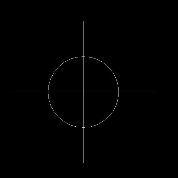

You can try PDMODE and PDSIZE to change how the points are viewed. I usually use PDMODE 34
It looks like this, there are others, try looking in your help file there is a list somewhere showing you all the options.
