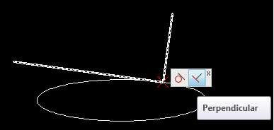

chaarr Posted November 25, 2010 Posted November 25, 2010 hello friends.. I have an ellipse drawn in autocad. can you please tell me how to draw a perpendicular line to the ellipse through a given point on that ellipse? Quote

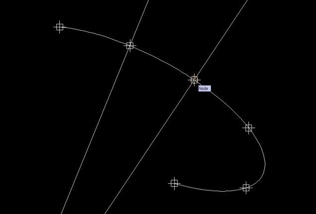

SEANT Posted November 26, 2010 Posted November 26, 2010 Another possible method: Xlines support deferred object snaps, so this command sequence precedes the attached illustration. Command: Command: Command: _xline Specify a point or [Hor/Ver/Ang/Bisect/Offset]: per to Specify through point: nod of A command macro to preset the action would be something like this: ^C^C_xline;per;\nod;\; The construction lines can be trimmed as necessary. Quote
