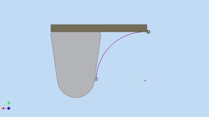

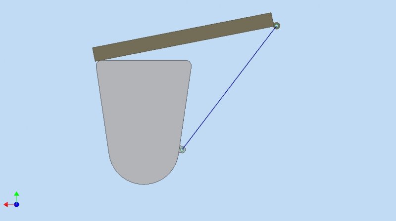

here is a challenge.
This spring ( blue line) needs to follow the rocker (dark part) as in the pics and the spring (blue line) must keep the same length
I don't know how to do it.
Any ideas?
Thanks in advance.

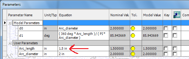

This ipt should give you some ideas (see attached).
There is also a scissors (or scissors1.ipt) included in Inventor that might give some ideas.
Arc Length.zip
Many thanks JD.
The parameters should do just fine.
