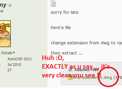

basiony Posted November 23, 2010 Author Share Posted November 23, 2010 Yes, the original was a rar file. I save it down to 2007, but it was still over 350KB and failed to upload for me as well. Wblock shrunk it down enough though. Here it is in 2007 format ** anyway ,, back to the mean topic ,, \ what about printing ... ??!! Quote Link to comment Share on other sites More sharing options...
Cad64 Posted November 23, 2010 Share Posted November 23, 2010 Yes, I missed that. Excuse me for being human. I am not perfect. But as I said, I cannot extract rar files, so I cannot help you. Quote Link to comment Share on other sites More sharing options...
Cad64 Posted November 23, 2010 Share Posted November 23, 2010 Ok, I just downloaded and installed some free rar extraction software, so I extracted your file and can now open it. The problem is that your FACETRES value is set at .5. Set it to 10 and try printing again. Quote Link to comment Share on other sites More sharing options...

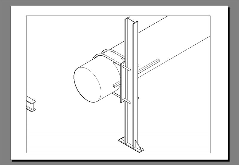

Cad64 Posted November 23, 2010 Share Posted November 23, 2010 FACETRES didn't work for me. The edges of the cradles are still not continuous, and the vertical line on the baseplate gusset is also completely missing? Same thing happens with the FLATSHOT command, those edges should be showing. I don't know then. It works for me. Shademode = Hidden Facetres = 10 Printing to PDF This what I get in the Plot Preview: Quote Link to comment Share on other sites More sharing options...
Cad64 Posted November 23, 2010 Share Posted November 23, 2010 Excuse me , but I don't know wat did u mean with facetres ... its first time hear that ... so, how can i set it as u say..?? Type FACETRES at the command line and change the setting to 10. Quote Link to comment Share on other sites More sharing options...

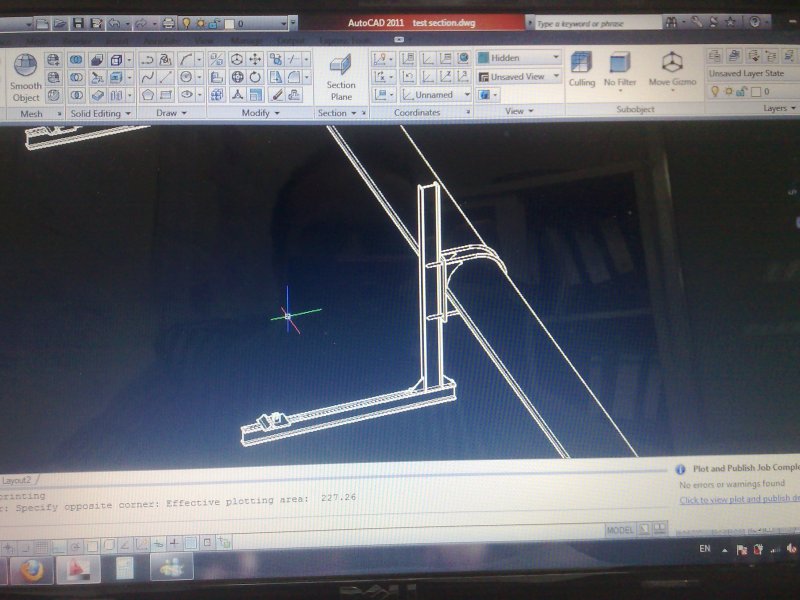

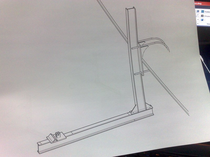

basiony Posted November 24, 2010 Author Share Posted November 24, 2010 Printing Problem [AGAIN], Here's ... >> ** note: I tried to print to PDF then paper in all situations, hidden and wireframe and also shaded , etc.. it's the same problem ... --- I searched the forums about a problem similar like mine , I didnt found anything ... thanks ,... Quote Link to comment Share on other sites More sharing options...

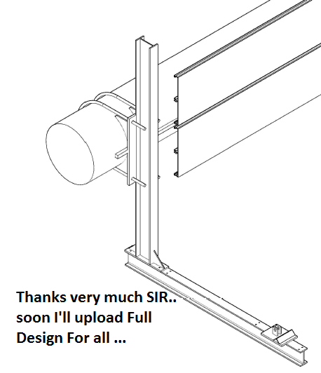

basiony Posted November 24, 2010 Author Share Posted November 24, 2010 So? Are you able to print now or what? Sure ,, here's ... soon I'll share the Design for all ... Quote Link to comment Share on other sites More sharing options...
