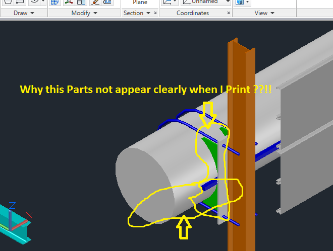

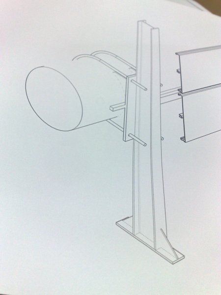

basiony Posted November 23, 2010 Share Posted November 23, 2010 Not appear some of my drawings such as lines and curves ...!!! ------------- thanks Quote Link to comment Share on other sites More sharing options...
designerstuart Posted November 23, 2010 Share Posted November 23, 2010 check layers? Quote Link to comment Share on other sites More sharing options...
ReMark Posted November 23, 2010 Share Posted November 23, 2010 Are you printing it as a 3D wireframe? Quote Link to comment Share on other sites More sharing options...
basiony Posted November 23, 2010 Author Share Posted November 23, 2010 Yes Mr. Remark ,, I tried it to Print in Wirefram... its same result Quote Link to comment Share on other sites More sharing options...

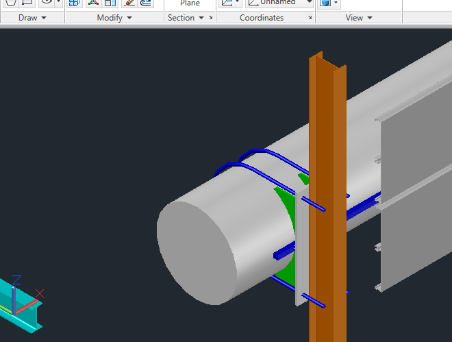

basiony Posted November 23, 2010 Author Share Posted November 23, 2010 adding for this also the two webs down ... same problem ... Quote Link to comment Share on other sites More sharing options...
ReMark Posted November 23, 2010 Share Posted November 23, 2010 Why are you using a double-U-bolt for securing the pipe? What is DISPSILH set to? Can you post the dwg file itself? Quote Link to comment Share on other sites More sharing options...

basiony Posted November 23, 2010 Author Share Posted November 23, 2010 about u-bolt ,,, I used two U-Bolts, cause in some case wind load will be over the design calculation ... and 90% of sign board dimensions here in Arab countries, are up normal safety.. === ** Mr remark, really I tried alot of times to search OR practice the Threads Tutorial in this sites and other... but still can't make a thread .. I know its very shame to say that ... but I honestly try much :$ Quote Link to comment Share on other sites More sharing options...
ReMark Posted November 23, 2010 Share Posted November 23, 2010 I'd use something like a heavy duty strut by B-Line or Hilti with a strut clamp. Quote Link to comment Share on other sites More sharing options...
nestly Posted November 23, 2010 Share Posted November 23, 2010 Remark, that's probably like a 12 or 16" pipe, cost may be a factor, plus I don't see anything wrong with that design to begin with. Redundancy isn't a bad thing either since dropping pipes on moving cars is always a bad thing, not to mention the additional stiffness that type of connection provides to the support beam. Back on topic, I don't have any experience printing 3D views like that, and couldn't figure it out either, so I'm hoping to learn something here as well. Quote Link to comment Share on other sites More sharing options...

ReMark Posted November 23, 2010 Share Posted November 23, 2010 (edited) I had no problem printing the drawing out without any loss of clarity. I printed it using a Conceptual visual style on a Kyocera photocopier. I wouldn't worry about putting threads on U-bolts of such small diameter. That level of detail will not show up unless you zoom in very close or you are going to plot it at a much larger scale. Personally I'd use a kneebrace of some kind to support the pipe from below or better yet a saddle. Are you going to be adding a second plate to the face of flange on the other side of the column? Edited November 23, 2010 by ReMark Quote Link to comment Share on other sites More sharing options...
ReMark Posted November 23, 2010 Share Posted November 23, 2010 Just out of curiousity why do you have only one layer? You have a beam off to the side, a column with baseplate and gussets, a backing plate, a pipe and two U-bolts. They may all be different colors but if someone wants to see just the backing plate and U-bolts what are they supposed to do? And another question if I may. What is the purpose of the square (stiffener?) between the pipe and the backing plate? Quote Link to comment Share on other sites More sharing options...
nestly Posted November 23, 2010 Share Posted November 23, 2010 What is the purpose of the square (stiffener?) between the pipe and the backing plate? I'd say it's there to prevent the pipe from rotating due to the weight of the sign and wind load: a keyway of sorts. Quote Link to comment Share on other sites More sharing options...
ReMark Posted November 23, 2010 Share Posted November 23, 2010 Makes perfect sense. Thanks. I thought the days of supporting signs with pipes held in place by U-bolts was over. What happened to something a bit more up-to-date? Quote Link to comment Share on other sites More sharing options...
