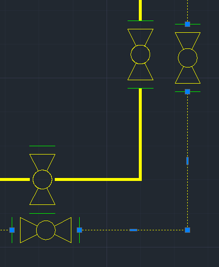

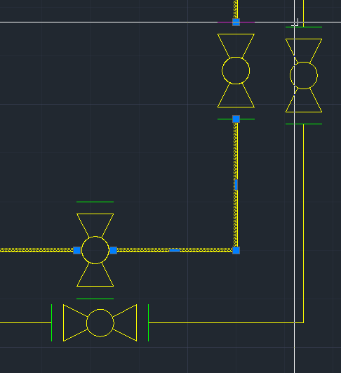

hi Lee, sorry i forgot to update you, i already fix that, however i have 1 more prob regarding ABB. When inserting block in a polyline with Globalwidth the auto rotate function cant seem to recognize the polyline.
notice the Global width of the 2 polylines and the valve symbol on the PL with GW.
Note: rotation is ON
Thank you for bringing this to my attention, I have now updated the program to V1.7 to hopefully fix this issue.
Please try the new version available here. :)
Lee
