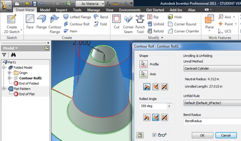

Ahh, you need Autodesk Inventor for that.
(I should add that the Inventor flat pattern doesn't look right to me.)
Edited by JD Mather

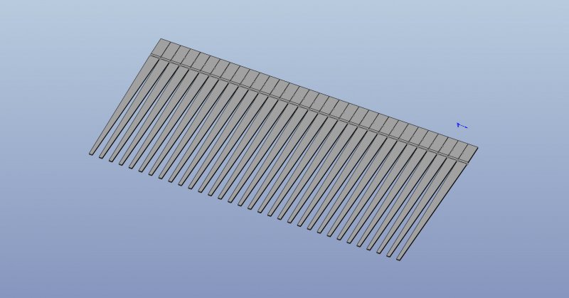

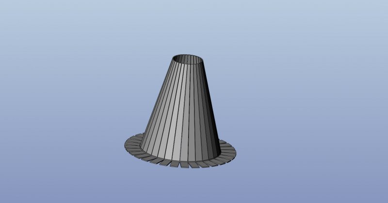

Dan, i dont think it will work because the flanged edge of the cone needs to be stretched around the cone rather than just bent. I dont think there is a way(in SW) to do that. Or at least I havent found it yet.
I agree........I don't think this could be done the way you expect in SW. You can however add reliefs/bends to cone section allowing it to flatten. See attached pictures. The result may be undesirable but I don't know of any other way. I plan on posting this issue on another forum, maybe someone can provide a different solution. I will keep you posted.
