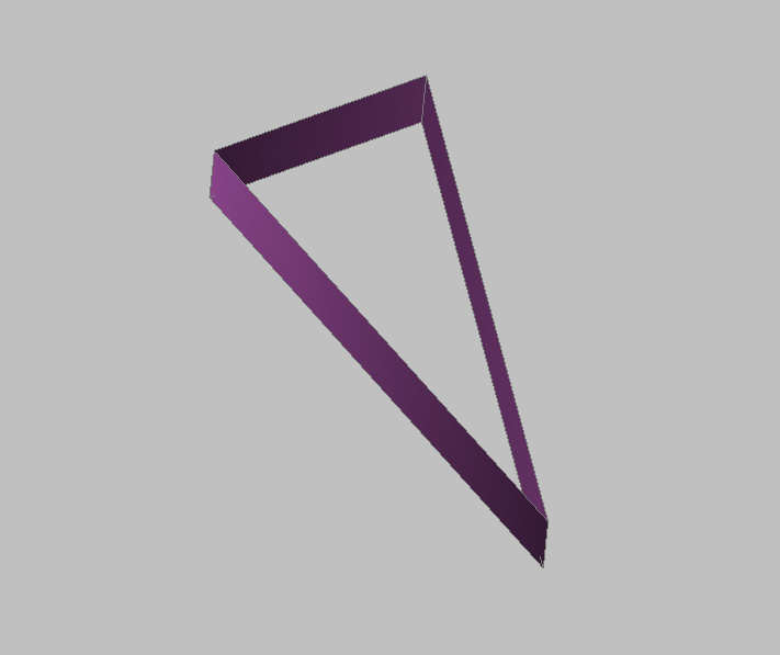

AutoCutter Posted November 18, 2010 Author Posted November 18, 2010 no I don't. but I have the feeling that there's something like ELEVATION or EXTRUSION which is applied to the shapes. the extrusion is always 5 centimeter. here's a screenshot of a triangle I've drawn. -> nothing added afterwards. I closed the polyline by pressing the "c" key! Quote
ReMark Posted November 18, 2010 Posted November 18, 2010 Type the word THICKNESS at the command line. Press ENTER. What is the default value shown between the symbols? If it is anything other than "0" type in "0" and press ENTER. Redraw your lines. Quote
ReMark Posted November 18, 2010 Posted November 18, 2010 Re: ELEVATION. Refers to the height off the drawing plane. Normally AutoCAD will draw everything at a "Z" elevation of 0. Draw a line and either check its Properties or do a List on it. What is "Z"? It should be "0". Quote
AutoCutter Posted November 18, 2010 Author Posted November 18, 2010 Hey ReMark, you are right. in the THICKNESS command the default value was "5". I changed it to "0" - now it works correct. Thx for the hint!!!!! Awesome. but in my point of view there's no logic why autocad should act like it does... Quote
