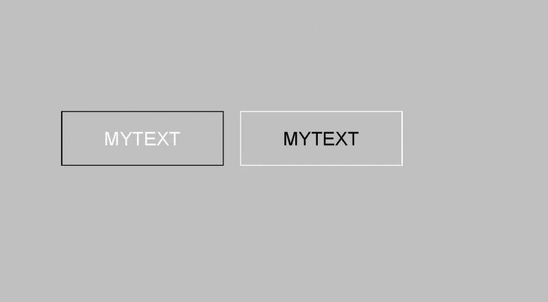

rkmcswain Posted November 17, 2010 Posted November 17, 2010 Black and white are usually the same color in AutoCAD - it displays white if you have white background and black if you run with a white background. True for color 7, but truecolor 0,0,0 will always be black, even on a dark or black background. Same for truecolor 255,255,255 which will always be white, even on a light or white background. Lastly, truecolors always plot as displayed, they are not affected by plot style tables. um... i want some parts to print black text/lines, and others to print black and to "not print" white text/lines. Hopefully the above will help. Quote
syzygy Posted November 17, 2010 Author Posted November 17, 2010 rk and tiger, thank you for your help remark, thank you for your humor i'll come back if i still can't make it happen, which i doubt now ___ my sig rocks yours Quote
ReMark Posted November 17, 2010 Posted November 17, 2010 Is this what you are attempting to achieve? It's based on rkm's advice. Quote

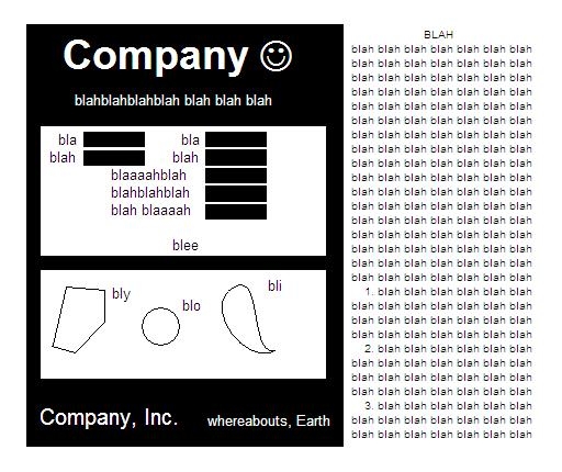

syzygy Posted November 17, 2010 Author Posted November 17, 2010 Is this what you are attempting to achieve? google search "data plate"; it's something along those lines. half of the page is black text on white, which is simple enough. the other half is a black drawing on white, black data plate on white, and white logos/company names on black Quote
Cad64 Posted November 18, 2010 Posted November 18, 2010 I would use Adobe Illustrator to create this type of thing. It's basically a hybrid program, somewhere between a paint program and a CAD program. Quote
Tiger Posted November 18, 2010 Posted November 18, 2010 google search "data plate"; it's something along those lines. half of the page is black text on white, which is simple enough. the other half is a black drawing on white, black data plate on white, and white logos/company names on black [ATTACH]24652[/ATTACH] A picture says more than a thousand words I would do the black stuff as a black (or truecolor near-black) hatch and a white text over it (use Send to Front/Send to Back to get them in the right order) and the black text just as black text. I would use Adobe Illustrator to create this type of thing. It's basically a hybrid program, somewhere between a paint program and a CAD program. What are you saying? That you can't do everything in AutoCAD, is that what you are saying, IS IT?? BLASPHEMY!!!! Quote
