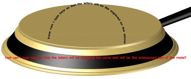

Californo Posted November 17, 2010 Posted November 17, 2010 Hi, I need to know please how to type letters like in the image below and that so they will follow the arch directions and to be stamped on the steel part or engraved on the stone Thanks, Quote

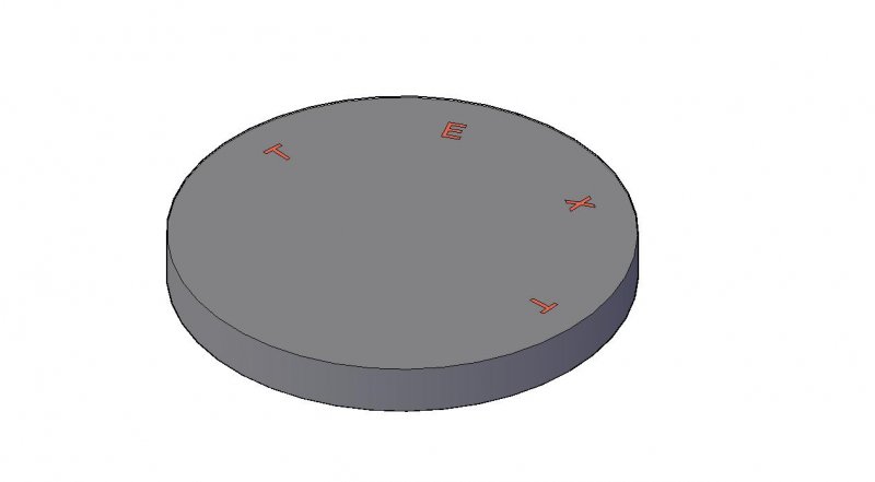

ReMark Posted November 17, 2010 Posted November 17, 2010 (edited) Funny, it didn't work for me either. I must have used a different text style. I'm baaaccckkk. OK. A cup of coffee was what I needed. I used the Express Tools Explode Text command then I used the Imprint command. Edited November 17, 2010 by ReMark Quote
ReMark Posted November 17, 2010 Posted November 17, 2010 Although the text and the circular object are one I can attest to the fact that the letters are indeed "imprinted' into the top of the solid. I used the Color Faces command to give them a different color than my solid. Quote

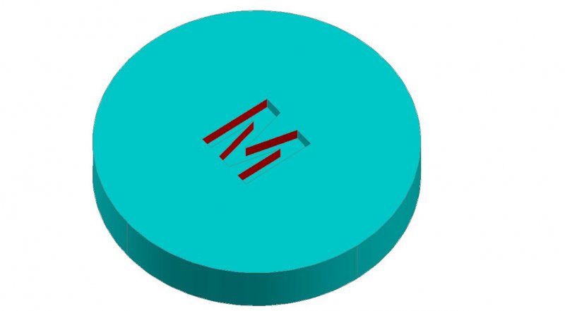

ReMark Posted November 17, 2010 Posted November 17, 2010 Another example. In this image the text was made into a solid using the PressPull command then subtracted from the circular solid. The text had to be exploded first. Quote

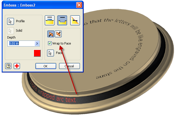

JD Mather Posted November 17, 2010 Posted November 17, 2010 (edited) It is still unclear to me where you want the lettering - on the flat planar face in an arc, or on the conical face wrapped around the cone? In the later case I think I would use a modern 3D CAD program like Autodesk Inventor (not sure if FREE Inventor Fusion will also do wrapped emboss/engrave - might be worth checking). Pan.dwf Edited November 17, 2010 by JD Mather Quote

Californo Posted November 18, 2010 Author Posted November 18, 2010 I need it exactly like in your image, Can i do that with AUTOCAD 2011? Quote

JD Mather Posted November 18, 2010 Posted November 18, 2010 I need it exactly like in your image, Can i do that with AUTOCAD 2011? It can be done in AutoCAD, but a lot of work. The arced text on the flat plane is not too difficult, but on the conical face requires placing text letter-by-letter after creating some construction geometry to easily change UCS as needed. Bit of work, but it can be done. If you have only a relatively small amount of text you might create your own letters rather than use a text font. Quote
