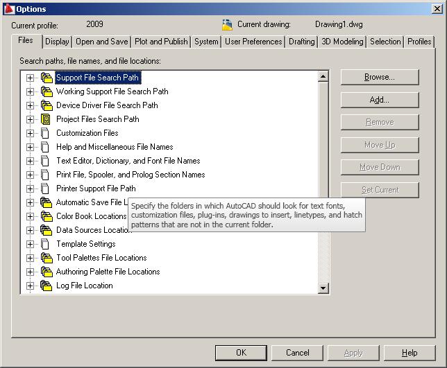

You must add the location of outlook.exe to the AutoCAD Search Support Path in your options.
