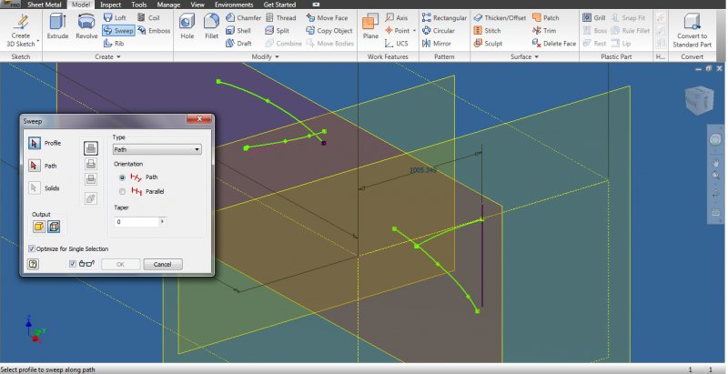

A little new to inventor. Using inventor 2010. I am trying to use a 3d intersection
curve to create a sweep. I want to use the 3d curve as the profile but am not able
to select it. If the image works the two lines in blue are the 2d sketches that
were used to create the 3d intersection curve and the red line is the path. The
purple line is the 3d curve.
Thanks in advance for any help.
I don't see your settings in the Sweep dialog box. Those are open profiles - did you set if for Surface output?
Can you zip and attach the ipt file here?
Have you gone through the tutorials in my signature?
I have it set for surface output. I am wondering if it is possible to create a sweep using a 3d intersection curve for a profile. If so how?
Sorry i don't see any tutorials dealing with this topic.
