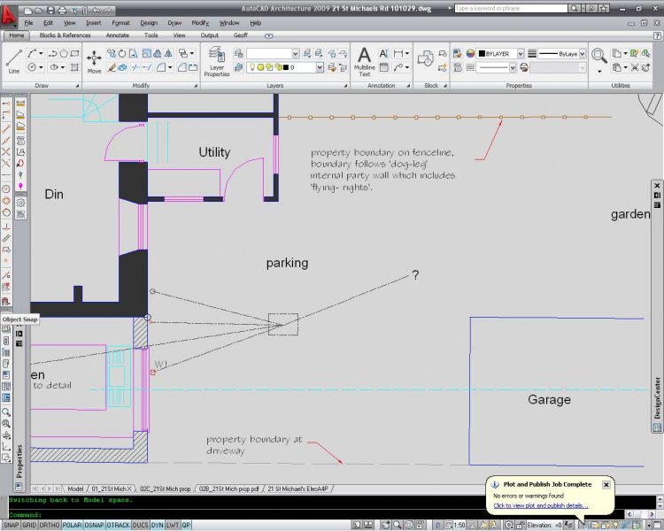

I know the embedded character problem in ACAD but can anyone explain why identically formatted text displays differently when output to pdf, please? As you can see the two notes starting 'property boundary...' are identically formatted / same style but show differently. The words 'Utility' and 'parking' likewise - but in another style.

The Width is different...
I keep my drawings without displaying Lineweights, perhaps you do the same? That would explain why the difference is not noticed until you plot it.

Does plot preview give you different results?
Nope, I have just made them identical width - still not the same in pdf. I used Changeprop.:(
I did not think 'width' was the problem but I am willing to try anything. I don't understand 'Normal' in listing has z=1 !! What's 'normal' here relating to text anyway? :?
...my first screen shot was 'print preview'...
I haven't paper plotted it but might try, generally don't need to as use on-line planning application service...
That first shot doesn't look like a plot preview to me but plotting to paper would tell you if it is a PDF problem or something else.
...paper plot is fine... so PDF seems to be THE problem???
Try a different PDF plotter like CutePDF (free).
I have PDF995 free so tried that
And
it is ok!:D:D:D
