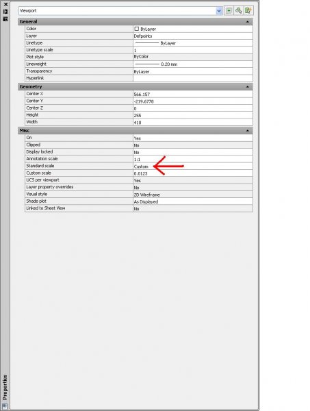

alan_mardan Posted November 1, 2010 Posted November 1, 2010 Hi every one, I use autocad 2011, i tended to have scale 1:1 from beginning and did all my drawings. When i print my layout, it shows a line of 8000 mm in the actual drawing as 6.5 cm measured by ruler on the paper. Please i need help with this issue to get a correct scale? Regards Alan Quote
qball Posted November 1, 2010 Posted November 1, 2010 If plotting from paperspace: - Viewport scale is correct? - Print Setup , Plot Scale is 1:1? If plotting from modelspace: - Print Setup , Plot Scale is correct? Quote
alan_mardan Posted November 1, 2010 Author Posted November 1, 2010 I am not an expert in this field, sorry all i do is that i draw in model space and prepare it for printing in layout page, using model view ''mv''. When i print from there i get print properties there i select window to select my drawing and then it says it is scaled to 1:1 or i can fit it to paper. But in both cases i don't get it right. For example 10000 mm does not give me 10 cm or what ever when i measure it with ruler. It tends to be 8 cm on the printed paper. I am sorry if i confuse you but as i said i am just a beginner and need to submit my Course work professionally Thanks Quote

qball Posted November 3, 2010 Posted November 3, 2010 i used to follow same procedure to print by viewport, but didn't scale it on the particular viewport border. It tended to be scaled very strange scale. I looked at your file and when I pulled up the Properties of the viewport, your Standard Scales weren't correct. The row highlighted should read 1:100 (or whatever desired scale is) but unfortunately now i cannot fit the layout to paper in print properties, which results in missing the outer border line of my dawing. In your print dialog box under the header Printer / Plotter click Properties (of the .pc3 file) then Modify Standard Paper Sizes (Printable Area). CHange the margins to 0, then it will print everything. I have one more issue, if i want to write notes about my drawing (e.g. Section sizes et.)should i do it in model space or directly in viewport space (layout i mean)? because i dont know if that would cause my building to be smaller. I use annotative text in Model space but some people use text in Layout / Paperspace Quote
