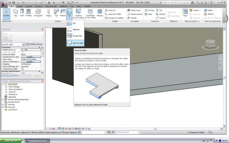

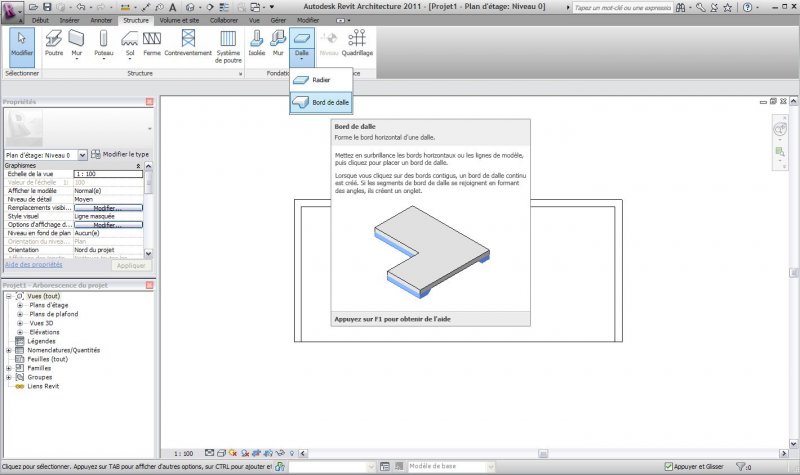

Hi Profcad
You means (see picture) I am not a sure about my translation for the second point could you show an example ?
Bye
Pascal
PS sorry I am just got a french version
Pascal,
Your images shows me how to start the slab edge tool.
I'm looking for the Load Profile tool so I can load my own custom Slab edge Profiles.
Thanks
