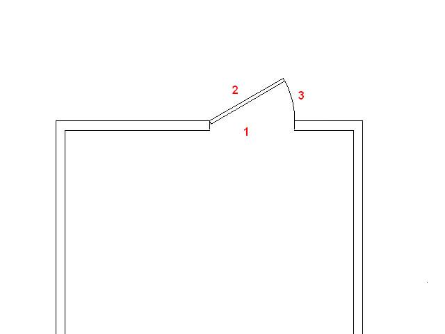

I am just getting used to using the blocks that come with the design tool catalog. I have a standard single door that I am inserting into a wall. I cannot figure out how to show the swing of the door in my model view. I can see it in the work viewport, but that's it. I can't see it in my secondary layout either.

I can see the door just fine. What I want to see is the "door swing," ie show how it opens.
Tell me if I'm understanding you correctly...you've modeled the door and wall in 3d, but you want to see the little door swing symbol in the model like you would if you were looking at the floorplan in a 2d plan view, right?
If you're using standard door block that includes the door, the jamb opening, and an arc representing the swing, I can't imagine how any of those 3 components wouldn't be displayed.
Is this what you're trying to do?
If you've modeled the floor, and I'm assuming you have, you'll have to make sure the door swing indicator has a z value that is above the floor, if only a couple thousandths of an inch or it won't be visible.
