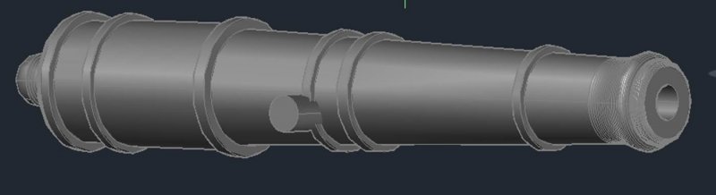

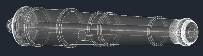

Maverick2805 Posted November 2, 2010 Author Share Posted November 2, 2010 yup, that's what my bad english meant with hole in the barrel it's great to see some progress in the drawings thanks to your help. Quote Link to comment Share on other sites More sharing options...

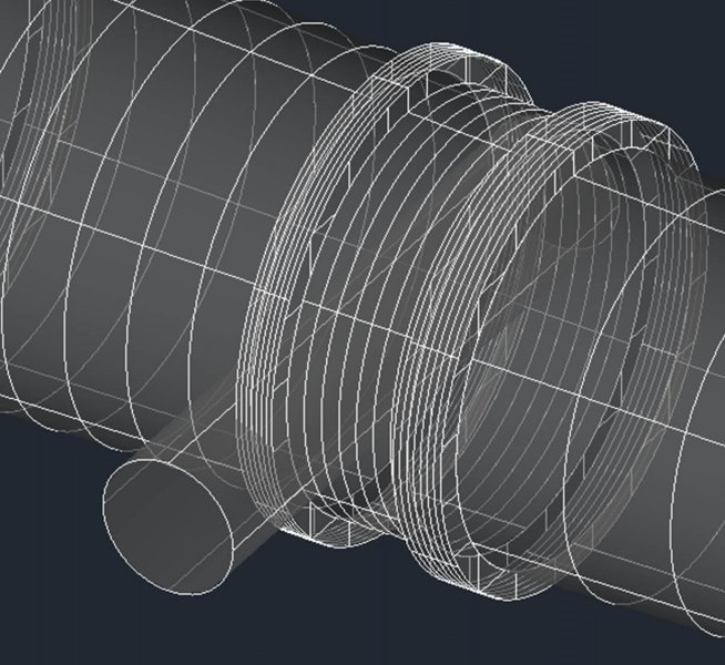

Maverick2805 Posted November 2, 2010 Author Share Posted November 2, 2010 one more question, the tilting bolt goes now through the cannon barrel, however it should only be there where the two ends show out, not through the whole barrel, as it will be casted in one piec of metal. I tried to union the surfaces, but that didn't work. Thanks for the help once more Quote Link to comment Share on other sites More sharing options...

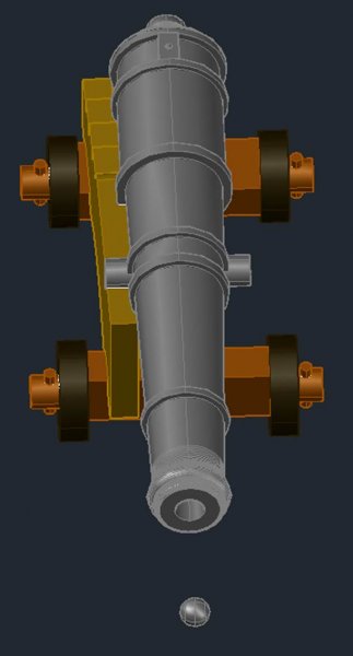

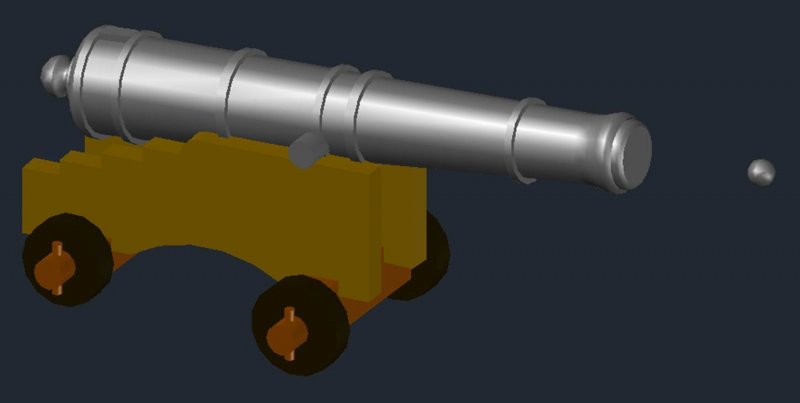

Maverick2805 Posted November 2, 2010 Author Share Posted November 2, 2010 I tested quickly how it'll look on the undercarriage, nothing fitted yet and still a lot of details missing Quote Link to comment Share on other sites More sharing options...
ReMark Posted November 3, 2010 Share Posted November 3, 2010 Surfaces? You used surfaces for you cannon's barrel? Quote Link to comment Share on other sites More sharing options...

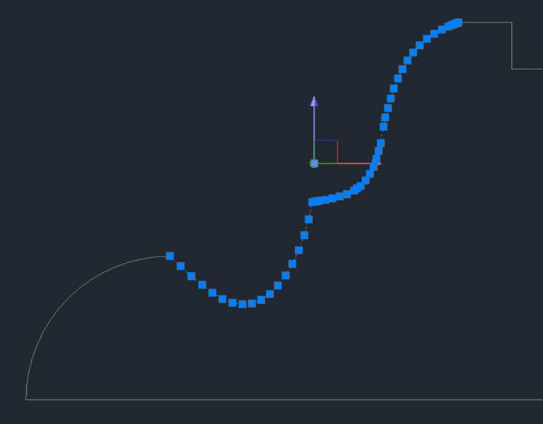

Maverick2805 Posted November 3, 2010 Author Share Posted November 3, 2010 I drew lines, and then "revolved" (dunnot the correct term, am in the office right now) them around the center line. It then gave me all different segments, like not in one part. hope this was correct because I already deleted the lines I drew ;-) Quote Link to comment Share on other sites More sharing options...
ReMark Posted November 3, 2010 Share Posted November 3, 2010 Lines? Then you have a revolved surface and not a solid. That would explain why you could not union the pivot pin and the barrel. Quote Link to comment Share on other sites More sharing options...
Maverick2805 Posted November 3, 2010 Author Share Posted November 3, 2010 hmmm, should I then have used polylines? Damn, now I can do it again Quote Link to comment Share on other sites More sharing options...
ReMark Posted November 4, 2010 Share Posted November 4, 2010 The polylines must be joined. Quote Link to comment Share on other sites More sharing options...
Maverick2805 Posted November 4, 2010 Author Share Posted November 4, 2010 Ah then Ill do them again :-)) i have to think about not drawing normal lines anymore but polylines. However it seems easier for me to use the normal lines rather then polylines, or can the nprmal lines, circles, splines etc. be converted into polylines? Quote Link to comment Share on other sites More sharing options...
ReMark Posted November 4, 2010 Share Posted November 4, 2010 Lines and arcs can be "converted" to polylines with the aid of the polyline edit command or Pedit (or just "pe" at the keyboard). The option to "join" other lines/polylines is available via Pedit. A circle cannot be converted to a polyline without a little "sleight-of-hand" using a lisp routine. Different commands (like Sweep, Extrude, PressPull) will have different results depending on what entities they are being used on. Quote Link to comment Share on other sites More sharing options...
Maverick2805 Posted November 7, 2010 Author Share Posted November 7, 2010 As the canon has in the first and last part some strange curves, I drew them using splines, I could convert them into 3D polylines, however they can't be connected with 2D polylines, is that correct? Do I understand this correctly, to revolve I need a complete joined polyline from start to end? Thanks again, Cheers Mav Quote Link to comment Share on other sites More sharing options...
ReMark Posted November 7, 2010 Share Posted November 7, 2010 No, you cannot join 2D polylines and 3D polylines. Revolve a closed polyline. If it is easier work on portions of the cannon and when you have all the sections created as solids union them together for the final object. Quote Link to comment Share on other sites More sharing options...

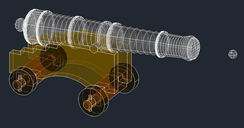

Maverick2805 Posted November 7, 2010 Author Share Posted November 7, 2010 okay, but how can I then do this with a 2D polyline? I think I'm struggling again to understand the concepts Thanks for your help and patience!!!! Quote Link to comment Share on other sites More sharing options...
ReMark Posted November 7, 2010 Share Posted November 7, 2010 I think I'd use a couple of arcs and a portion of an ellipse. Look how zoomed in you are on the portion of the cannon you are working on. Are you going to be able to reproduce that level of detail when the object is actually created? Quote Link to comment Share on other sites More sharing options...
Maverick2805 Posted November 7, 2010 Author Share Posted November 7, 2010 That's a valid question And i think the question is no, but I'll try to get it as accurate as possible anyways. There are other things I will have to change at a later stage, for example the with of the two blocks for the axles, the part next to the hole is most probably too thin to reproduce with wood. For the barrel, I have now created segments, twice 2D polylines, and twice 3D polylines, will now try to revolve them and then union them when they are solid. Quote Link to comment Share on other sites More sharing options...
Maverick2805 Posted November 7, 2010 Author Share Posted November 7, 2010 THAAANKS for your help!! Now The details of the barrel have to be done. Quote Link to comment Share on other sites More sharing options...

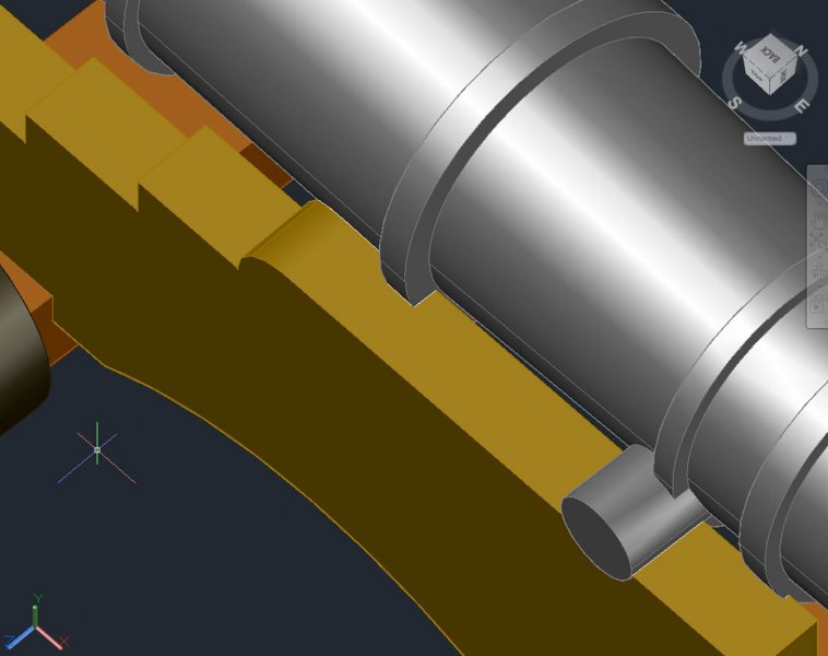

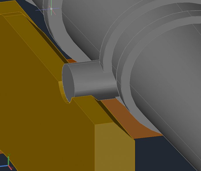

Maverick2805 Posted November 8, 2010 Author Share Posted November 8, 2010 Seems as If I have done some measurement errors the barrel is conflicting with the sidewalls i hope I don't have to redraw everything it's stupid that I noticed that only now when puting the pieces together Have no idea where the problem was. Quote Link to comment Share on other sites More sharing options...
ReMark Posted November 8, 2010 Share Posted November 8, 2010 Could you "shave" some material off the rib(?) that protrudes into the side frame? Quote Link to comment Share on other sites More sharing options...
Maverick2805 Posted November 9, 2010 Author Share Posted November 9, 2010 Thanks for the tip Here is what I have done, I chamfered the edges, which I also can easily do when building the piece Quote Link to comment Share on other sites More sharing options...
ReMark Posted November 9, 2010 Share Posted November 9, 2010 That's one way to solve the problem but did you check to make sure that as the cannon is raised and lowered that all the "ribs" do not make contact with the sides? Quote Link to comment Share on other sites More sharing options...
