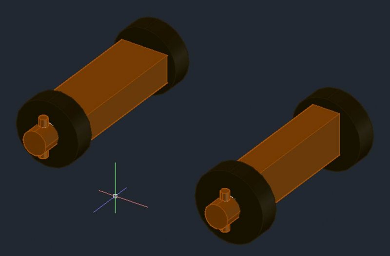

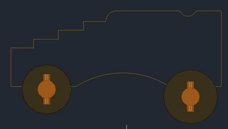

Maverick2805 Posted October 31, 2010 Author Posted October 31, 2010 I know it's just babysteps, but I managed to do the second axle assembly quite quickly Quote

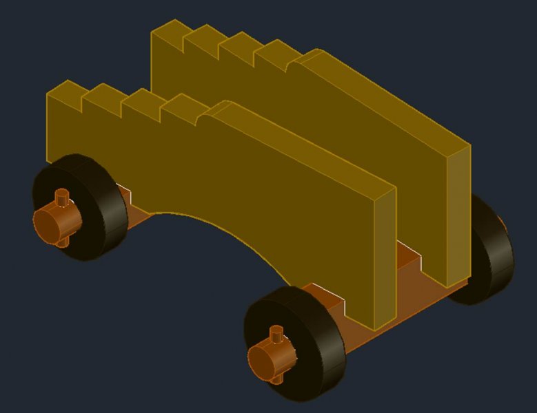

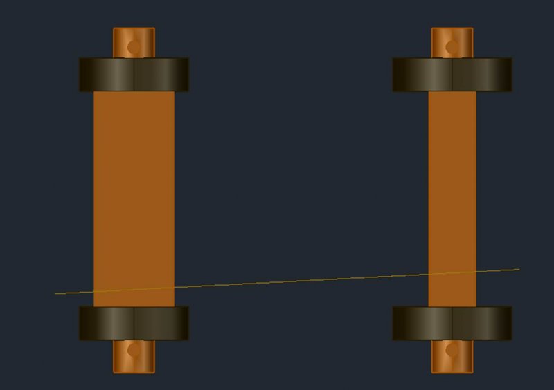

Maverick2805 Posted October 31, 2010 Author Posted October 31, 2010 I drew the Sidewalls with single lines, but now I am struggling with the either PEDIT or Press pull, with both I seem to make mistakes. With presspull, it tells me that no regions are found. With PEDIT, selecting with multiple all the lines, the choice I would assume is close? but that doesn't work, the cursor just jumps around and gives me all the options again. Here is what I have done so far I rotated all the lines in a 3 degree angle. Quote
ReMark Posted November 1, 2010 Posted November 1, 2010 There is a button at the bottom of the screen that will turn the Dynamic UCS On/OFF. Hover above the buttons with your mouse and a Tool Tip will identify the right one. If you used lines to create the outline or profile of one of the sides then you should use the PressPull command to extrude it. If you used Polylines then the entire profile must be one continuous polyline. Using the Pedit command with the Join option should give you the desired result. Then use the Extrude command on it. Either way your UCS must be oriented correctly to achieve the depth you need. By the way, your profile is at an angle maybe your UCS should be at an angle too (rotated around the Z axis)? Quote

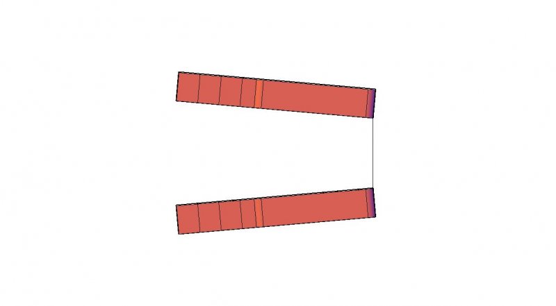

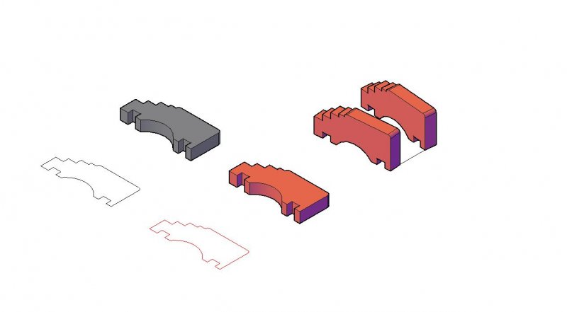

ReMark Posted November 1, 2010 Posted November 1, 2010 (edited) Maybe the image below will be of some help. I drew a rough approximation of the outline (profile) of the carronade using lines (black) and using polylines (red). To give the lines depth I then used the PressPull command. To give the polylines (Pedit used to make one continuous polyline) I used the Extrude command. As you can see the results of both methods are the same. I rotated one of the 3D solids so it was standing up. Then I rotated it again at a 5 deg angle. I mirrored the object to acheive an approximation of the top view of the carronade sides as seen in your image (F1/2). Edited November 8, 2010 by ReMark spelling Quote
ReMark Posted November 1, 2010 Posted November 1, 2010 Top view of carronade sides. Note: Neither this image or the one above where done to scale. They are an approximation of the general shape only. Quote

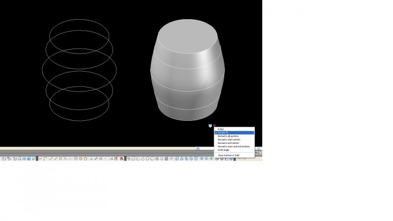

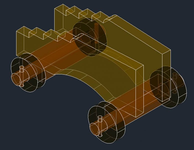

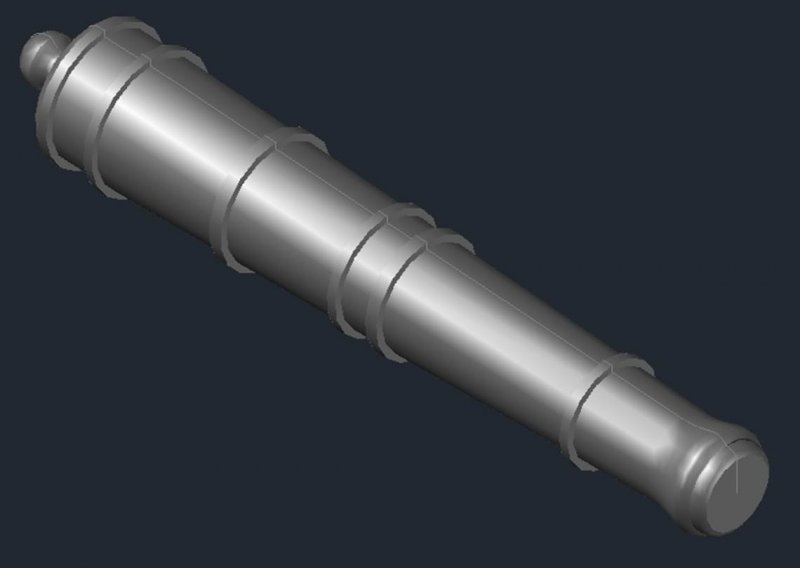

Maverick2805 Posted November 1, 2010 Author Posted November 1, 2010 I think I am geting the hang of the Views and UCS, the dynamic UCS not yet but it'll come. I managed to understand building things with Poly Lines, that's the result! Thanks for all your help ;-) Another Question though, the subtracting thingy, for taking out the parts where the axletrees cross the sidewalls, is there a possibility to substract the area in the sidewall, but that the axletrees will remain there and not get deleted? Before I copied them away, substracted the part and moved them back again, it's a bit of a pain and I'm sure it works somehow easier ;-) I've started with the barrel, does this need to be polylines as well to revolve around a centerline, or can it be normal lines? Thanks again for your patience Quote
dumfatnhappy Posted November 1, 2010 Posted November 1, 2010 esiest way to make a barrel (perhaps) is throw down some circles realizing the contour desired...... using the LOFT command pick them in order and it's done Quote

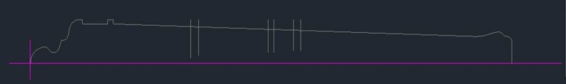

ReMark Posted November 2, 2010 Posted November 2, 2010 Re: Subtracting out axletrees (?) from sides. I'd do it the way you mentioned (make copy, subtract, move copy back in place). Only because of the angle (not perpendicular). The cannon's barrel could be done using Loft as df&h has suggested above but I think you'll find that some of the detail will be difficult to reproduce this way. I'd suggest a half-profile down the length of the cannon's barrel. Keep in mind this will be tapered. This profile could then be revolved as you indicated. You'll have to subtract a cylinder representing the bore if you do not incorporate it into your half-profile. Quote
Maverick2805 Posted November 2, 2010 Author Posted November 2, 2010 That's what it says in my book ;-) the block around the axle. Okay, I'll do it with the copy, and move back way. Thought, it'd probably work a bit easier ;-) Yes I think it would be difficult to get all the details of the cannon's barrel the way df&h has described. I will draw the half profile, and then I'll see if I can get a nice barrel. What I don't know yet is if I want to make the end product, the finished ship with movable parts, as in the cannon could "shoot" out smoke, or the sails could be raised, etc. This would mean a different approach in building the canon and also a lot more work in the end, drawing wise and building wise. Quote
ReMark Posted November 2, 2010 Posted November 2, 2010 That level of detail would take your ship to a whole different level that's for sure. Just don't load any grapeshot in the cannon. Quote
Maverick2805 Posted November 2, 2010 Author Posted November 2, 2010 I'm not sure if scale 1:33 would be too small for such mechanics Difficult to tell. I have a model of the USS Constitution in 1:96, which amazes me how detailed it can already be, so I thought it should be possible to do movable parts to some extent in 1:33. This would mean a height of 2.03 meters and lenght of 2.68m. But the with is only 40cm, which is not too much space anymore I am working on the barrel of the carronade, wondering if it'll work the way I want Quote
Maverick2805 Posted November 2, 2010 Author Posted November 2, 2010 There are still some details missing, such as the "hole" in the barrel plus the Tilting bolts, and firing mechanism Quote
ReMark Posted November 2, 2010 Posted November 2, 2010 Looking good. Don't forget the bore otherwise you'll have no place to put a cannonball! Quote
