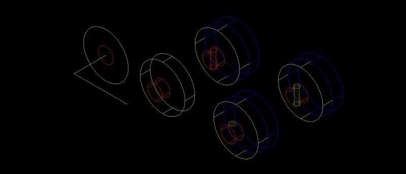

ReMark Posted October 30, 2010 Posted October 30, 2010 The following was done to illustrate a point. It is not to scale. Image above uses a visual style of 2D wireframe. So you see we have started with two very simple circles and have used either Extrude of PressPull to give them some depth. The first large wheel is copied to mimic what your image depicts. Another smaller circle is located on the portion of the axle (in red) that protrudes. This circle (green) is extruded downward then it is subtracted from the axle thus leaving us with a hole. My UCS for the entire series of steps was either as I previously described (with Y pointing at the top of the screen) or in its normal position with Z pointing at the top of the screen. Quote

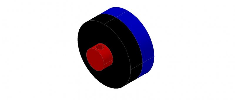

ReMark Posted October 30, 2010 Posted October 30, 2010 This is what the end result would look like using a visual style of Realistic. Quote

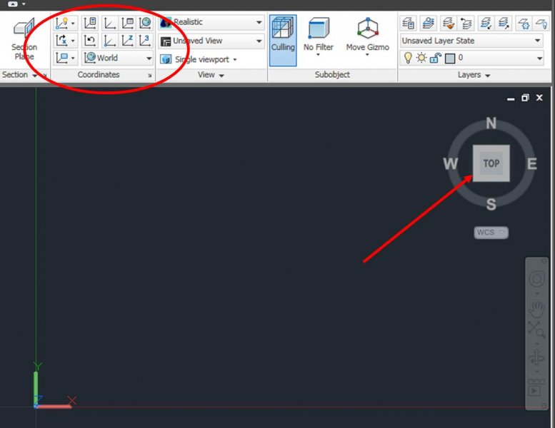

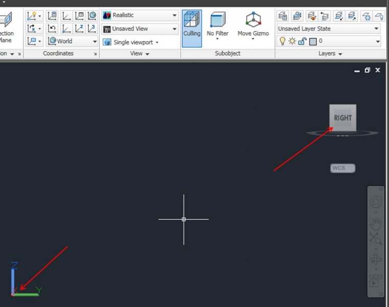

Maverick2805 Posted October 30, 2010 Author Posted October 30, 2010 That's the basic setup when I load the 3diso template, with Top labeled on the View Cube. Am I correct, that this would be the View for drawing the view of F1/2 bottom right? And the one that is circled, is the area where I should do the UCS manipulations? Now if I click onto right on this view cube, I'll get the view from the right, however the axes are not correct as you stated earlier. Could you be so kind to tell me step by step which icons I have to press that I get to that view? What JD Mather suggested, is that somehow, drawing the wheel in the top view and then tilt it 90° so that it would be then round in the view from the right? Sorry if I am a nuisance, then I'll stop bothering you! Quote

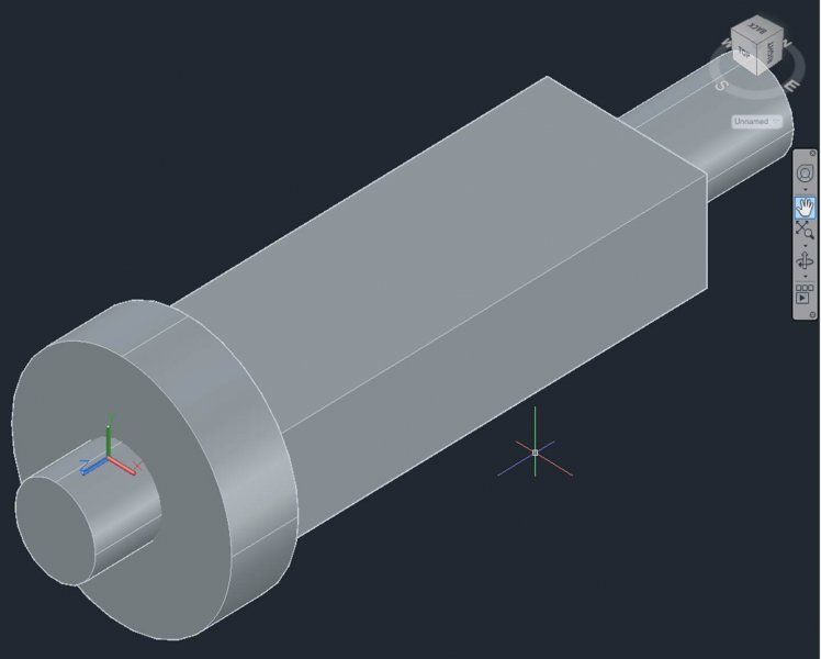

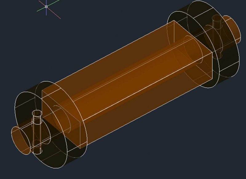

Maverick2805 Posted October 30, 2010 Author Posted October 30, 2010 I think I might have understood how at least the 3 point UCS modification works How does this look like? I still need to do several things, i know, making the hole into the square block, making a hole into the Wheel, etc. But for this I have to go through some tutorials first ;-) For those who also read this thread and are noobs like me, I first created the block, when finished, i clicked in the ribbon --> coordinates onto 3 point, and selected the lower left corner as origin, the lower right corner as point on the x axis, and the top left corner as point on the y axis, then I could start drawing cylinders the way I needed it. (a Pro would probably explain this differently ;-) ) Quote

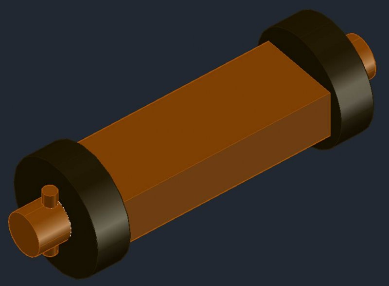

Maverick2805 Posted October 31, 2010 Author Posted October 31, 2010 And now with all the holes in the respective part, the back axle is finished but now the difficult Part starts with the rest of the carronade ;-) thanks again for your help! Much appreciated Quote
ReMark Posted October 31, 2010 Posted October 31, 2010 I'm not a big fan of the NAVVCUBE so I rarely use it if at all. You are working in the 3D Modeling workspace are you not? And you are using the Ribbon right? The answer to both questions should be "Yes". Look on the Home tab. On the View panel you have the option to see the top, front, side, etc. views. With Dynamic UCS enabled you can activate a face to draw on. It takes a little practice to get used to how this feature works but once you get the hang of it you won't have to manipulate the UCS via the keyboard. In your last image above I think the peg that keeps the wheel from sliding off the axle is located too close to the wheel. You can use the Move Faces command to slide it away from the wheel to gain a bit more clearance. It looks like you are making some progress. Keep it up. Sorry I could not respond sooner to your questions. I'm doing a true 3D project myself...installing a new ceiling in my front hall! LOL I'd rather be doing it in CAD. Sheetrock can get heavy working overhead at a height of nine feet. I'll check back later today if I can but I've got to get back to work. Got to tape the seams and install the corner bead. Fun, fun, fun! Quote
