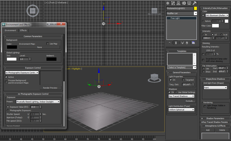

Cad64 Posted October 29, 2010 Share Posted October 29, 2010 Even in a new file? I thought this problem was related to your imported CAD file? Photometric lights cast light a specified distance which is based on the intensity of the light. The light starts to decay as soon as it leaves the source, so you may need to increase the intensity in order to see it. Try putting the light right up next to a surface and render. You should see at least a small glow on the surface. Also, when you create the Photometric light, are you clicking "Yes" when asked if you want to use "mr Photographic Exposure Control"? It's important that you click "Yes" when the message appears. You also need to choose an Exposure Preset in the "Environment" dialog, based on whether you're doing an indoor or outdoor render and whether you're doing a daytime or nighttime render. Choose the preset that works best for your render. Quote Link to comment Share on other sites More sharing options...
Cad64 Posted October 29, 2010 Share Posted October 29, 2010 Here's a screenshot of a simple plane with one photometric light. You can already see the light being cast on the plane, just in the viewport. Quote Link to comment Share on other sites More sharing options...

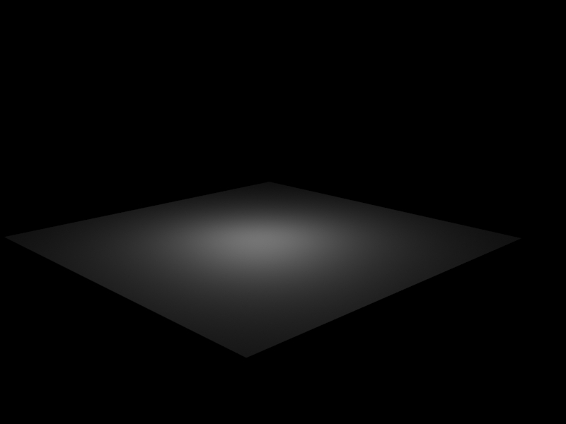

Cad64 Posted October 29, 2010 Share Posted October 29, 2010 And here is the rendered image: Quote Link to comment Share on other sites More sharing options...
