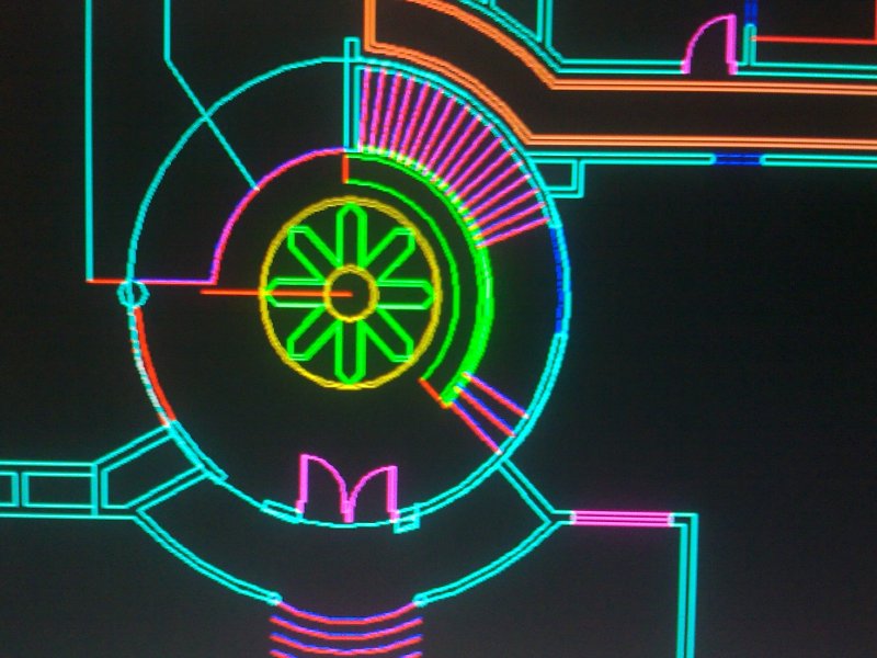

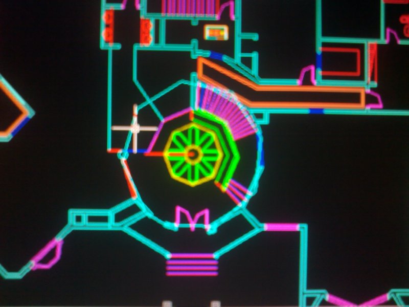

i had done this 2d plain before open this plain i had given coomand re and then saved it and closed the au and again i opened the same plain but the plain has changed the shape can u give me any solution
Are you referring to the fact your circles now look like polygons?
Try increasing the value of VIEWRES to something like 500 or 1000.
hi
sorry sir i dint get exactly wht ur saying bcoz iam new to this feild
i had applied wht u had said but the plain is same
I set VIEWRES at 5000. What did you set it at? 500?
First type VIEWRES `enter' at the command line and set it to 4000.
Now type SHADEMODE `enter' 2D `enter'.
Finally if necessary type REGENALL `enter'.
hi
thx rkent its work thx for ur help
