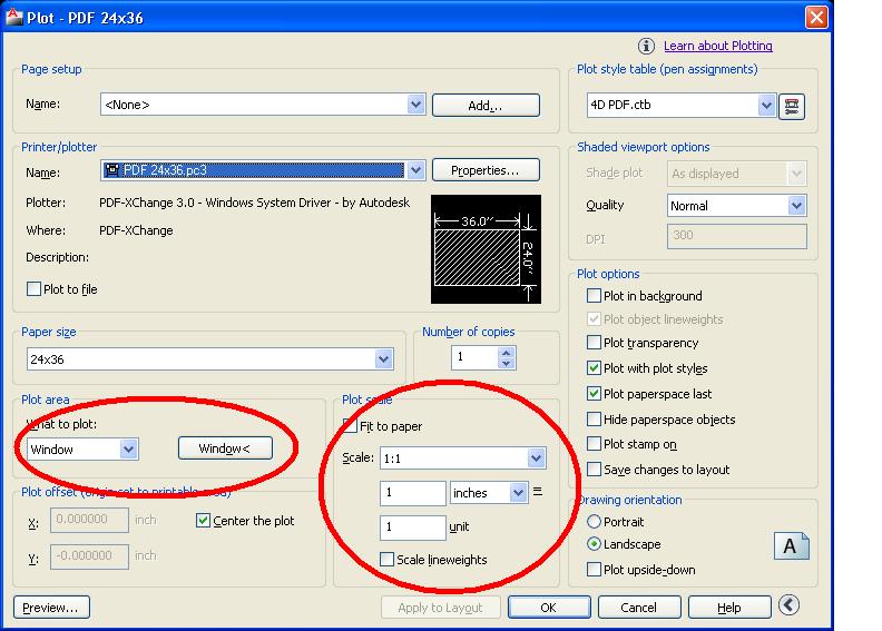

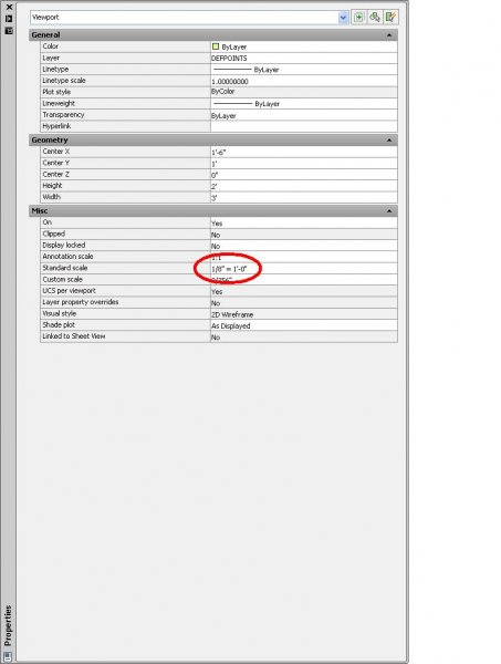

Claudia Posted October 26, 2010 Posted October 26, 2010 Hi there, forgive me if I don't make sense but I learned AutoCAD in a second language, and in metric, and now I have to figure this out in another unit. I have a drawing which is 1:1 (feet) on MS. When I plot (from PS) I'm using a 96 scale factor so that the drawing is 1/8" =1'-0". But when I measure the plotted drawing, there's about a 1/2 feet discrepancy. What should i do to fix this? Could the scale in the viewports be wrong? How do I fix that? Thanks for any help. Claudia Quote

qball Posted October 26, 2010 Posted October 26, 2010 Plot scale is correct in your Plot Dialog box? and window / extents / layout selection? Quote
Claudia Posted October 26, 2010 Author Posted October 26, 2010 Plot scale in plot dialog box is 1/8"-1'-0" Quote
Claudia Posted October 26, 2010 Author Posted October 26, 2010 Yes I use window/pick, then select the entire page that is on Paper Space ( with the company info etc), it plots well on an A1 size page, but it measures incorrectly after plotted, for example, a 10' wall ( that was measured with DIST as 10' in MS) reads 1/2 inch longer. (using an architect scale at 1/8) Quote

Claudia Posted October 26, 2010 Author Posted October 26, 2010 Going back to your idea, maybe it is the plotter: I just did a test - drew a line 10' long and printed from a regular printer, using 1:1 measurements on MS, zooming the viewport 1/8xp on PS and printed using a 1/8"-1'-0". It measures correct. I think its the plotter!!!!! Quote
qball Posted October 26, 2010 Posted October 26, 2010 If you're viewport is scaled to the standard scale of 1/8" = 1'-0", then your plot scale should be 1:1. If they are both 1/8" = 1'-0" the viewport would be scaled down by 96 and it would be tiny, but not out by just half foot. Only other thing I can think of is printable area. Your pc3 files, plotter driver and actual printer can all have printable area settings. Sometimes they don't always play well together. So this is your first project with the new company? Is anyone else in the office having the issue? Quote
ReMark Posted October 26, 2010 Posted October 26, 2010 When plotting from a layout there should be no need to use the "Window" option under "What to plot". The correct choice for plotting the entire drawing is "Layout." Quote

Claudia Posted October 26, 2010 Author Posted October 26, 2010 The moment of truth....tchan tchan...YES it printed correctly, thanks Qball! ( I had to replace the paper roll, that's why it took me a bit longer LOL) I was probably doing the viewport scale wrong. Thanks RKent, will save your instructions too if I need it in the future. Much appreciated. Quote
