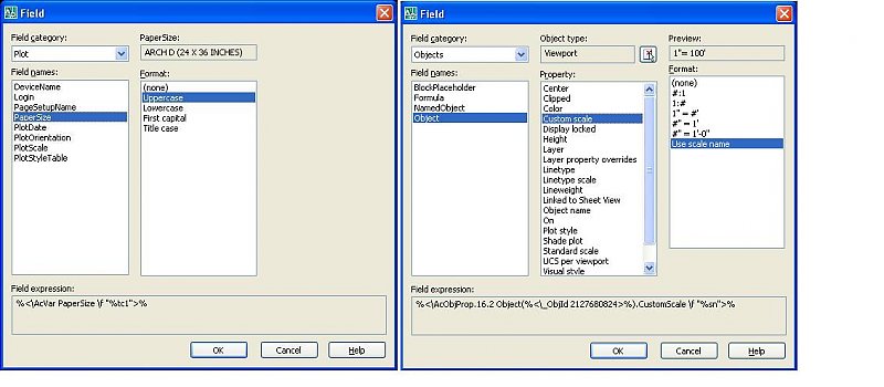

I have created a legen with help from here but there is one little problem I'm now stuck on.
I wish to indicate at what paper size the drawing is scaled. i.e. as in the title of the thread.
The only way I can see to do this is to create it as an attribute, in which case I will have to fill it in each time. Or create it as text, which will the need me to create a seperate block for each paper size.
Is there no way of doing this automatically ?
The default value of an attribute can be set to constant.
Constant: Gives attributes a fixed value for block insertions.
You could probably do it with Fields. The object in the second window is the viewport
Well that's my point..... its not constant as this value varies between layouts.
However, think I have sorted it by setting the attribute as a preset.
So by specifying this pre-set each time, before I insert the block into each layout, then it seems to sort it out.
