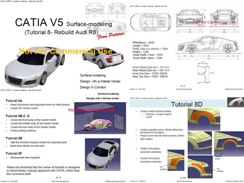

My CATIA tutorial 8- Rebuild Audi R8 (1:1)
Highlights:
- freeform 3D curves
- surface merging & trimming
- disappearing fillets
- solid modeling
- assembly design
- design with a master model
- design in context
You can now download the complete training pdf (9MB) via http://www.dicksonsham.com
