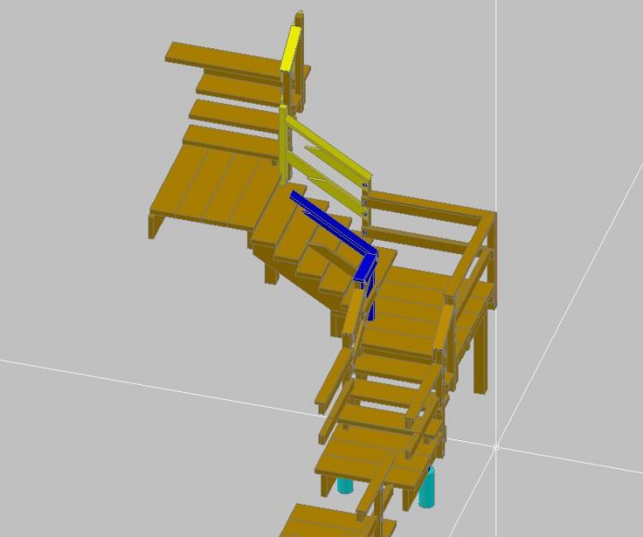

and attached is what I currently have. I don't know much about the insides of computers so I need a little help. How is the Intel i7? Any good? What is the difference between "860 @ 2.80GHz" and "1.17GHz" on the line below?
My computer seems to get jammed up when I do anything that I still consider to not be overly complicated. I'm sure some of you guys have far more complex stuff than this.
The 3d stairs attached is about a 5.5MB file.

Why is the file size so big? I've got more detailed 3D drawings than the one you show that are nowhere near that size.

As far as the file goes, I erased the 2d Flatshot blocks, 2d text, and Section Planes and it reduced the file to under 3MB and runs a lot better now. Seems like I'd like to leave those section planes in so I can quickly make a new block if I make any changes to the model.
