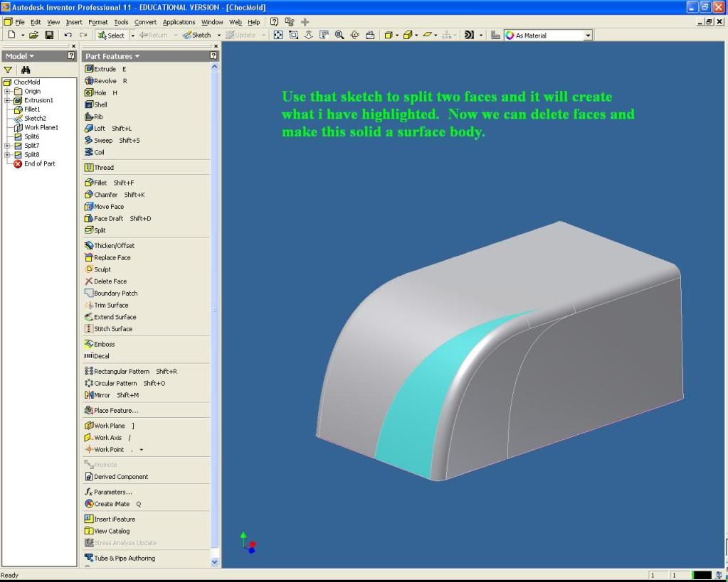

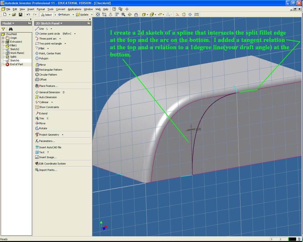

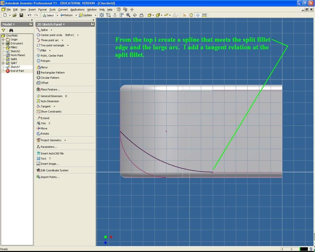

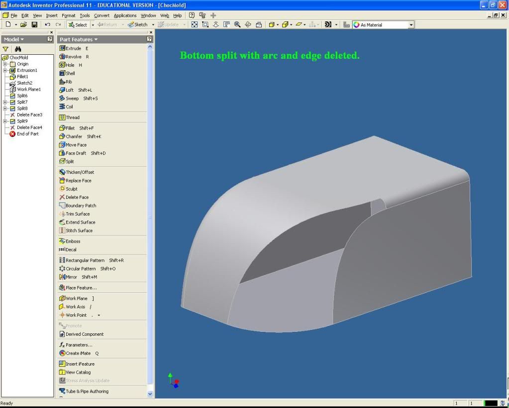

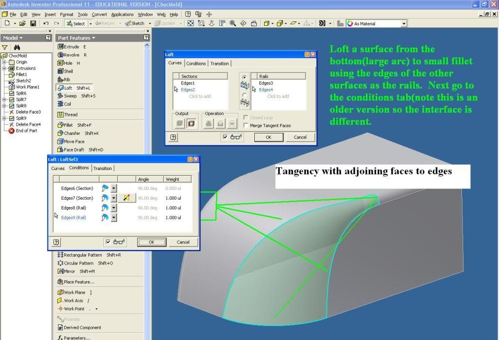

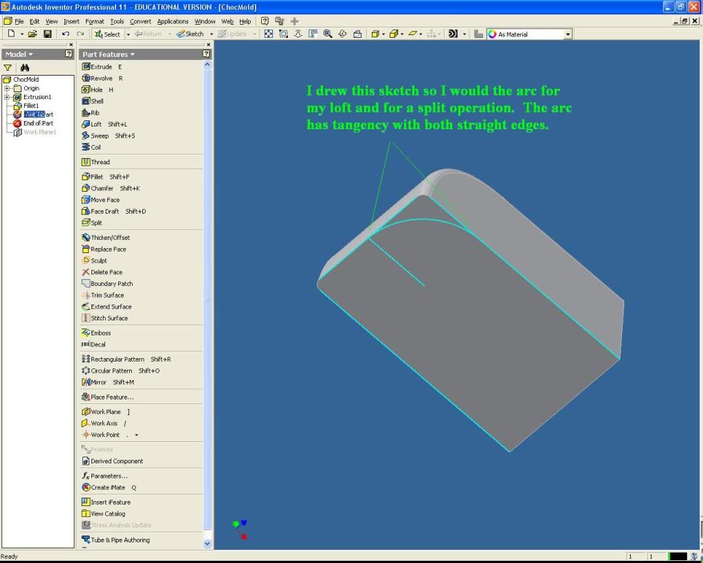

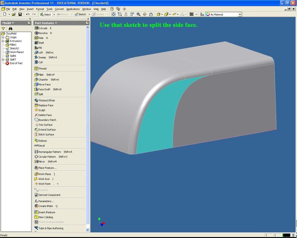

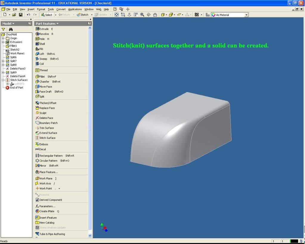

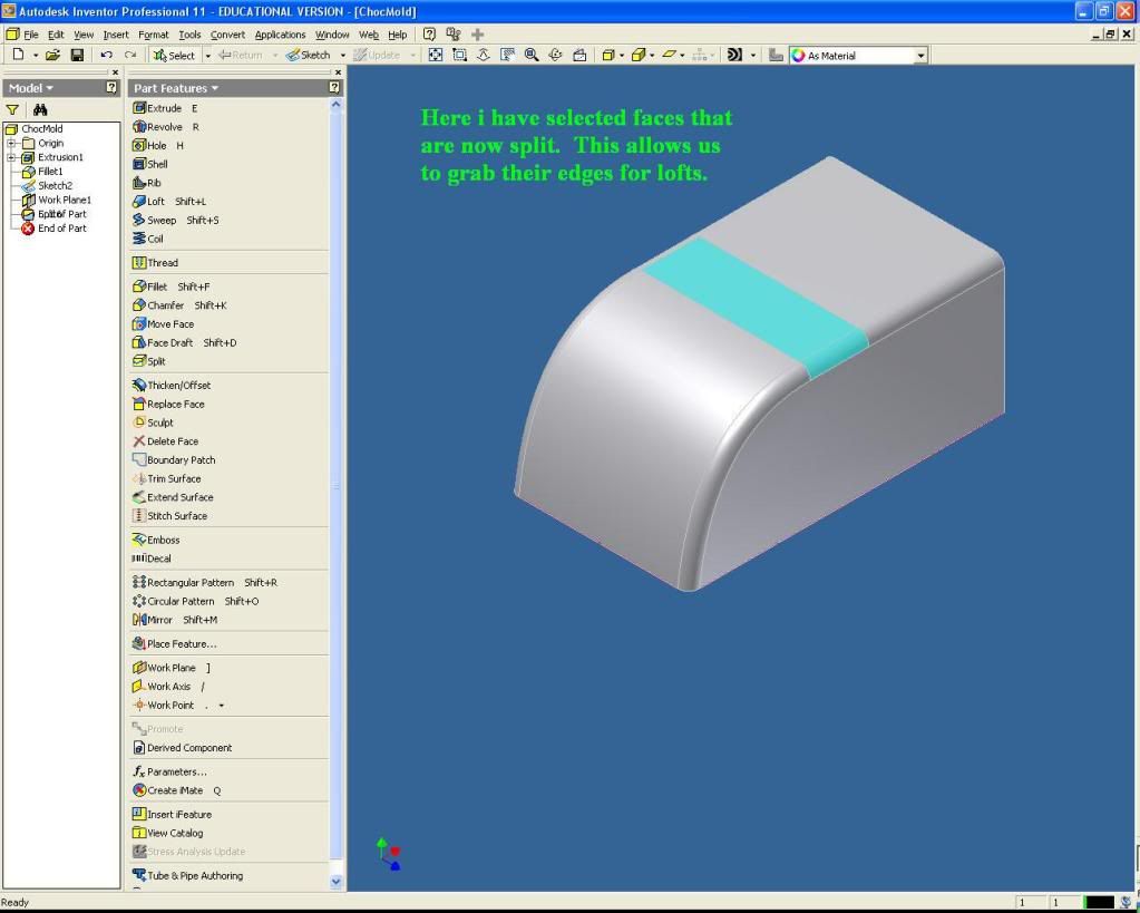

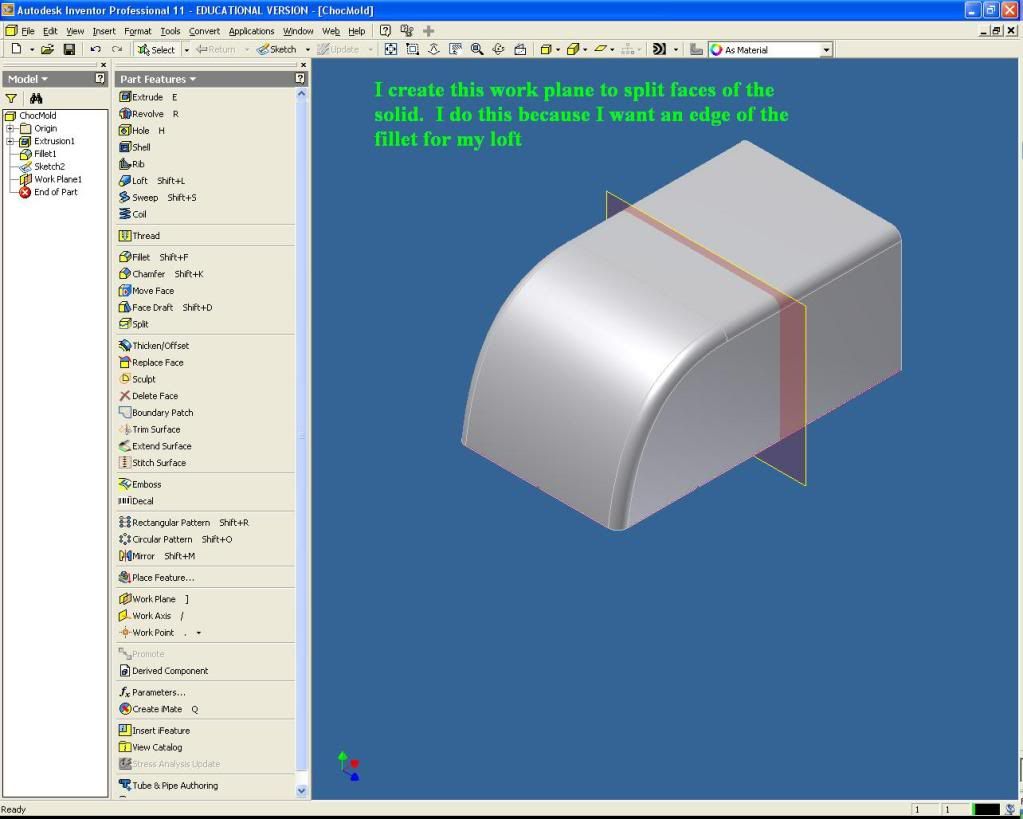

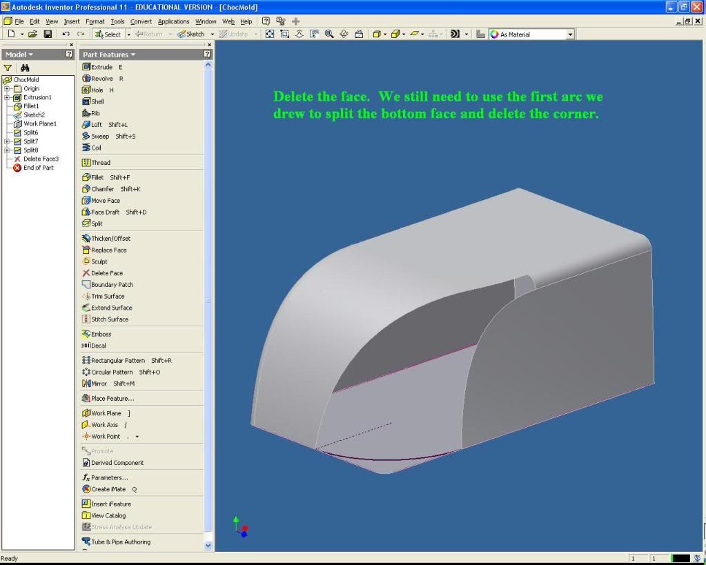

Josh here are some step through steps for you.
ChocMold.zip

I had to put the last two images on another post, too many links for one post.
Josh,
Do your dimensions represent the "part" or the mold to make the part?
I assume this is the part that will be molded.
I didn't see any indication of face draft.

Hey Matt,

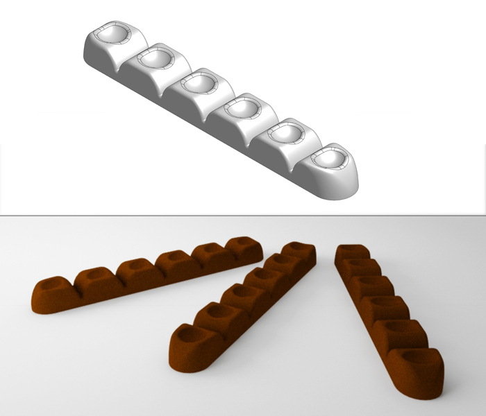

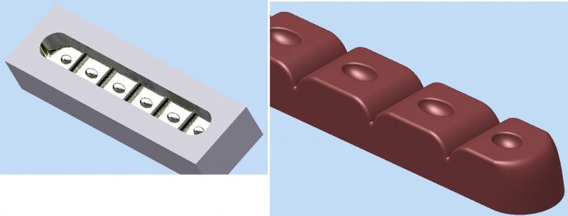

I've literally just finished it, luckily the client extended the deadline till today. (I know a client extending a dealine and not reducing it for once, I didn't know existed :)).
Attached below is one of the versions of the mould, I think I managed to do something that worked using your absolutely amazing (and idiot proof) guide Matt. Obviously not as good as your one, but hey I hope they get the idea. I honestly can't thankyou enough for taking the time to take all the screenies, and clearly explain it, that even this CAD monkey could understand. :)

Looks good josh! glad you got it all sorted out for the client in time:) For your file to be mold-able you would just need some draft on the side wall(maybe). Since the chocolate is poured hot and probably the molds are chilled they will skin/shrink and draft may not be needed. The only experience ive had with chocolate molds were thermoformed molds that the chocolate could be pushed out.

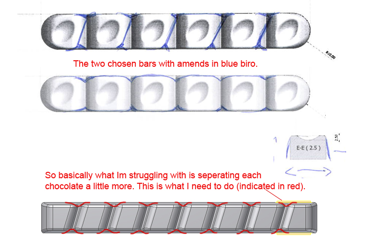

The client got back to me yesterday with amends to the drawing :cry:
Basically they have asked for a draft (taper) on the sides of the bars (as you guys warned me about). They also want diagonal cuts through one of the bar, and also on both bars they would like each chocolate section to be seperated more.
I'll attach some pic's to help explain .

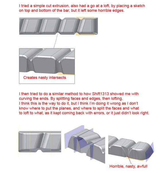

What I need to do:
The below cut outs are what Im struggling with.
So I would really love some guidance on where I should be splitting the faces, and what edges to loft to one another (similar to shifty's drawings). Or if there is a simpler way of doing this.
I hope that all makes sence. Any help would be greatfully apreciated.
J
PS: Ive also attached the inventor part file (2010) in its current state, before cutting the sections out and curving the two ends (which I can do, but leaving till the end). If it is easier for anyone to just have a play with that and see if they can do the extra cuts into the choc sections.
Choc Bar E2 JK.zip
Josh ill take a look at your file later but this type of thing is much easier to do before you fillet anything. The blend you are trying to make is a little more complicated than the one we did on the end. What i would probably do(assuming i had start from where the model is at now) was do some splits from the top. In this case you would almost seem like a fillet surface(cant remember if thats what inventor calls it) would be best. Basically instead of a start and end curve for lofts you select a boundary in which you can apply face tangency to.
Hi Matt, thanks for your speedy reply.
Oh right, I didnt think it would be easier before the fillet, its things like that, and the method/order of working I still do stuggle with on Inventor.
Im all ears to the best way and in what order I should draw/construct this model so just advice me and I will do it :).
