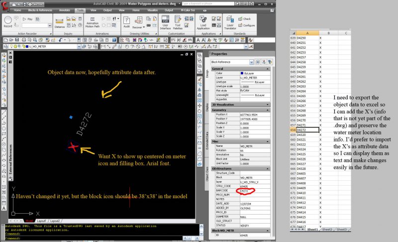

I have thousands of campus water meter locations (a block with a small icon, attribute data, and object data) that belong to two different systems, domestic water and lake water. Each of these blocks has object data item (a barcode tag) that I want to show as a label next to the block.
However, before I do that, I want to export that barcode data to an excel file so I add a column (eventually a new piece of attribute data) that says whether or not that specific water meter is radio read or manually read. I want to then import that radio read/manual read excel file back into autocad and have an X appear on the block icon if it is radio read. I also want the barcode information to show up as a label.

Image summarizing what I have and what I need:
